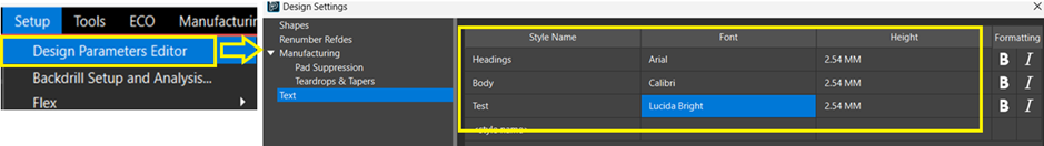

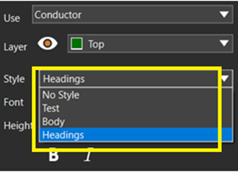

To get started, simply click the Add Text      icon found in the floating toolbar. A window will pop up, allowing you to choose a font type and set your desired font height. Take this opportunity to define your class and subclass as needed.
You can also customize and save your font style preferences for future use. Just head to Setup > Design Parameters Editor, select Text, give your style a name, and choose your preferred font type and height. You can even specify the format to make it your own.
Your new style will be readily available in the drop-down menu, making it easy to reuse and streamline your design process.
