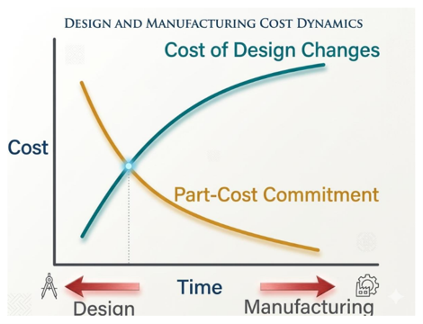

Why Thermal Teams Need a Different Optimization Workflow
The motivation is straightforward: fixing design issues early is far less costly than addressing them after production. Yet high-performance systems keep getting more complex, with tightly coupled interactions among airflow, component placement, and thermal behavior.
Cost vs. tiime graph for design and manufacturing
That complexity is pushing conventional trial-and-error design to its limits. Engineers spend significant time building detailed models and running repeated simulations to balance competing requirements. In this study, manual optimization stretched across several months while program timelines remained fixed. The need is clear: a faster, more effective approach.

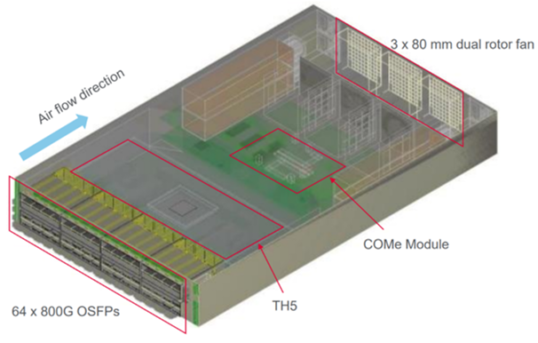

The System: A High-Power Network Switch with Tight Thermal Trade-Offs
The use case was a 2U network switch with 64 Octal Small Form-factor Pluggable modules (OSFP), a Tomahawk 5 device, and a Computer-on-Module Express (COMe) module positioned behind the OSFP modules. The 100% air-cooled platform carried about 3 kW of total thermal load and was designed for a 45°C ambient environment.
2U network switch
The simulation model was built in Celsius EC solver and ran at 70 million grid cells. Air is designed to flow from front to back, and the Tomahawk 5 and COMe module receive air preheated by the OSFP modules, creating the central thermal tradeoff in the design.
The Design Problem Was Not a Single Hotspot but a Balance Problem
The core challenge centered on the frontal open area. Reducing it increases airflow velocity through the OSFP modules and helps cool them, but it also reduces fresh air to downstream components, raising temperatures on the Tomahawk 5 and CPU-related hardware.

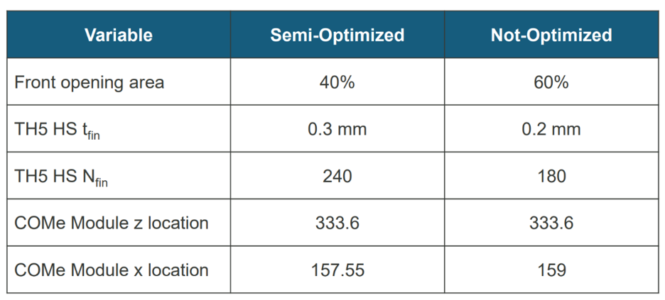

Testing Whether AI Depends on the Starting Design
To test how much the starting point affected the outcome, the study used two initial conditions: a semi-optimized design created by a thermal engineer through trial and error, and a not-optimized design with arbitrarily selected variables. This made it possible to assess whether Optimality could improve performance from different starting conditions and still reach the same optimal configuration.

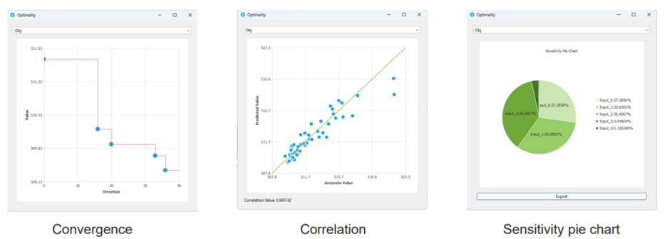

What the Optimization Data Showed
The raw optimization data captured the full range of studied variables and outcomes. Within that dataset, Optimality identified one scenario as the most efficient design and minimized the global objective function across a broad design space.
Computational fluid dynamics (CFD) convergence in Celsius EC Solver was also monitored, and the temperature values converged well, supporting the reliability of the results.
The analysis focused on convergence, correlation, and sensitivity. The convergence plots showed how Optimality navigated the design space and systematically improved thermal performance.
Sensitivity analysis identified front opening area, heat-sink fin thickness, and number of fins as the three most important variables.
Most importantly, comparing Optimality predictions with full 3D CFD results yielded a correlation of 0.93, demonstrating that the AI-driven predictions were both accurate and reliable. Rather than relying on thousands of computationally heavy full 3D CFD simulations, Optimality uses AI-guided design space exploration and surrogate modeling to learn the relationship between design parameters and thermal performance.
This allows it to evaluate and rank potential design alternatives using far fewer CFD runs, dramatically reducing optimization time while still converging on solutions that closely match full-physics results.

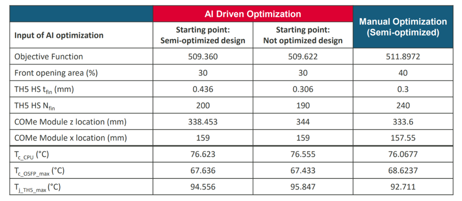

What Changed When AI Was Compared Directly with Manual Optimization
Manual optimization was already strong, which makes the comparison meaningful. It scored 511.9 on the objective function, while the AI-driven approach reached 509.36, outperforming the manual solution on a difficult thermal balancing problem.
A key result was consistency across starting inputs. From the semi-optimized design, Optimality reached 509.36. From the not-optimized design, it reached 509.622. That near match suggests it can arrive at essentially the same optimal configuration from more crudely selected starting conditions. The optimization also indicated that, at this airflow, AI favored a thicker heat sink with fewer fins for the Tomahawk 5 than manual optimization did.
