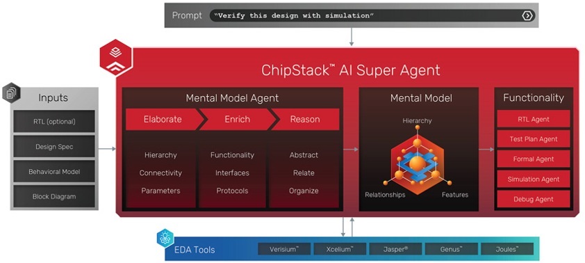

A mental model provides a structured, persistent representation of the design intent and current design state. It can bring together approved specifications, architecture, constraints, hierarchy, dependencies, prior results, and verification context so that the agent can reason about the design as a connected system rather than as isolated files or prompts. The mental model is derived from approved sources; it does not replace them as the authority for engineering decisions.
This distinction is important. The mental model gives the Super Agent the context needed to plan and execute work, while approved specifications, versioned constraints, qualified libraries, verified IP, and signed-off databases remain the authoritative engineering sources.

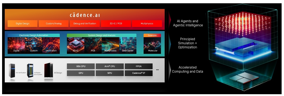

Cadence AI Super AgentsCadence AI Super Agents combine this contextual understanding with agentic reasoning and orchestration, specialized agents, and trusted Cadence EDA technologies. The result is an agentic workflow grounded in established design methodology and engineering engines rather than a general-purpose AI system operating independently of the design flow.

Chipstack AI Super Agent
Cadence’s agentic verification workflows illustrate this model. ChipStack AI Super Agent can generate verification artifacts and use Cadence engines such as Xcelium Logic Simulator and Jasper Unified Formal and Static Verification Platform to evaluate them. Xcelium can compile and execute agent-generated testbenches, run simulations, and return structured results. Jasper can evaluate generated formal harnesses, assumptions, assertions, and cover properties against relevant reachable design states.
