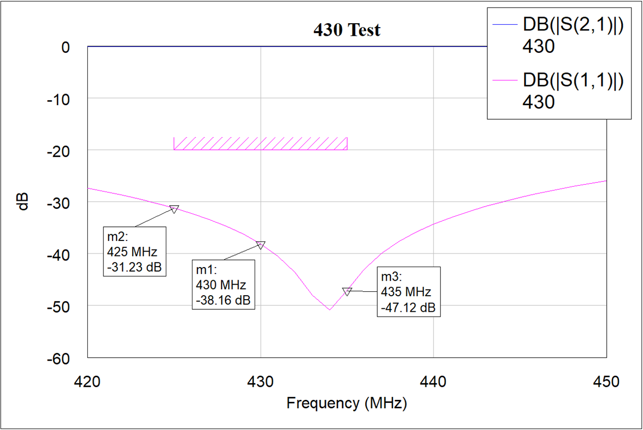

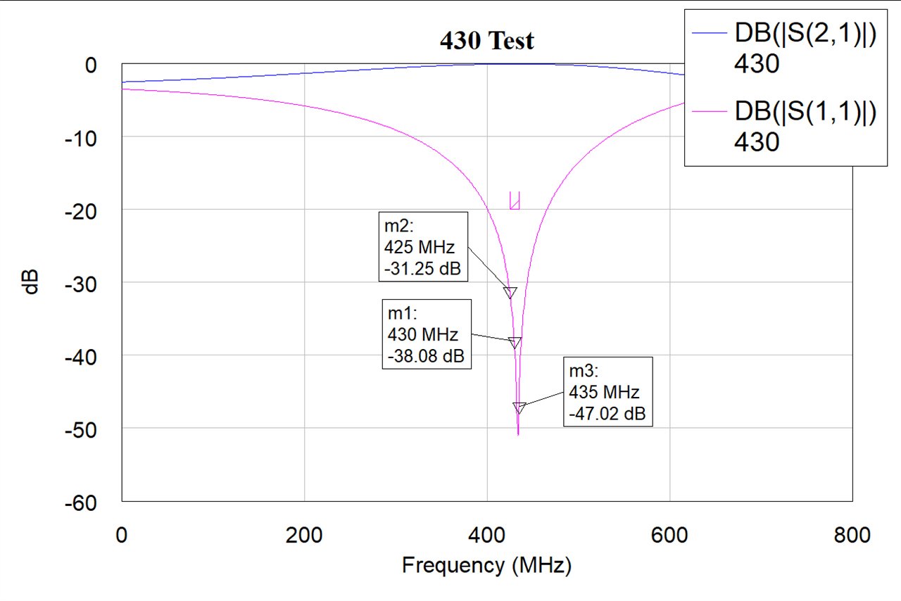

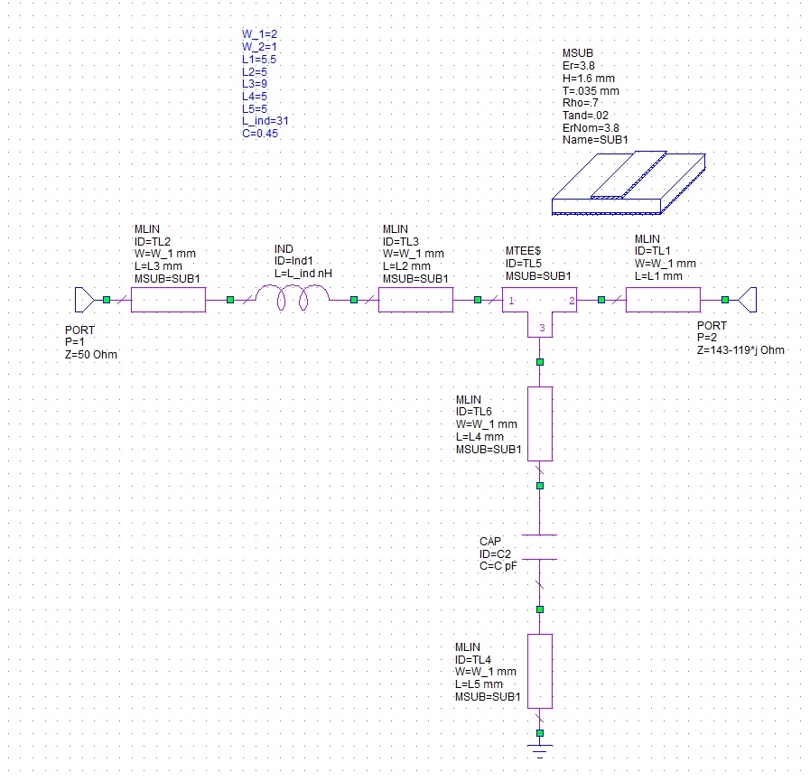

To interface our dual-band nested helical antenna with the transceiver front end, our team needed 2 impedance matching networks for both frequencies. We used a temporary solution of a piece of aluminum wrapped around the antenna’s connectors to act as a stub matching network, varying its dimensions to decrease S11 reflection. However, this gave only slightly better results than no impedance matching, achieving 90% transmission, -10 dB S11 loss for both frequencies. In order to achieve better S11 measurements, AWR software was used to design and simulate lumped element L-shaped matching networks to match our 145 MHz and 430 MHz helical antennas.
Since each board addressed a single frequency, we treated the matching problems with respect to each antenna. We synthesized component values in AWR software and used the provided simulation to tune our inductor and capacitor values against S11 and S21 parameter plots. Further capabilities were explored by employing the optimization function to determine a better impedance match for our S11 parameter. The final simulated designs achieved an S11 measurement of approximately -50 dB at each target frequency, and around -20 dB within a wide frequency range.

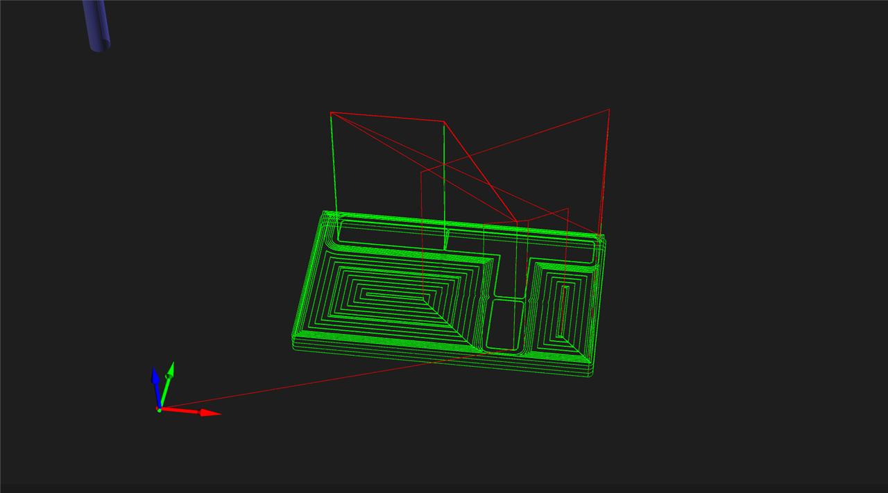

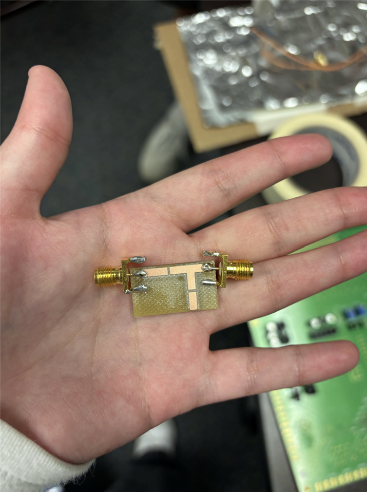

After designing both matching networks in AWR software, the PCB layouts were exported as a Gerber file and used to create a CAM design for CNC fabrication. The CAM design included two contour toolpaths around the traces to precisely remove the surrounding copper and isolate the transmission lines. A square pocket was then machined around the exterior of the traces to remove the remaining excess copper, and a final outer contour was used to cut the completed PCB out of the larger copper-clad board.
Once the PCB was fabricated, SMA connectors were soldered onto each end of the board. The final step will be to solder the surface-mount inductors and capacitors onto the PCB, completing the physical implementation of the matching networks originally designed and optimized in Cadence AWR software products.
