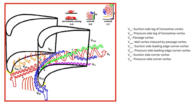

The design of the Aachen turbine features an unshrouded rotor armed with cylindrical, untwisted, airfoil-shaped blades. This configuration is crucial as the blade curvature generates a pressure differential, creating high pressure on the pressure side (PS) and low pressure on the suction side (SS). This differential drives the flow from the PS to the SS, resulting in transverse secondary flows that deviate from the primary axial direction.
Visualization of secondary flow structures in the turbine blade passage (Khadim et al., 2017)
Understanding the mechanisms behind secondary flow formation requires an appreciation for boundary layer effects. Low-momentum fluid accumulates near the walls, which is then swept away by the pressure-driven cross-flow. This process generates secondary vortex systems, including horseshoe vortices (HSVs) near the blade’s leading edge. These vortices split into two legs at the stagnation point, ultimately contributing to the formation of a passage vortex (PV) and inducing wall vortices. Additionally, corner vortices arise at the blade-wall junctions due to the interaction between the boundary layer and crossflow.

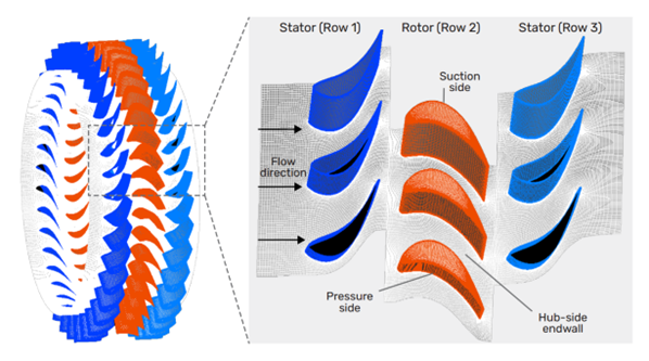

The first step in addressing secondary flow challenges is setting up a robust simulation environment. The Fidelity CFD includes high-fidelity mesh generation, with automated grid generation that transforms complex geometries into high-quality meshes for CFD analysis. It adeptly handles both unstructured and structured multi-block meshing, allowing for precise capture of flow dynamics. In this case, a structured, multi-block mesh is generated for one passage per row using pre-defined turbomachinery templates that allow for minimal user input.
Simulation begins with geometry definition, based on meanline design parameters. Parameters include blade profiles, hub and shroud contours, and dictate the flow characteristics throughout the turbine. Next, meridional flow paths specify the trajectory of the working fluid (in this case, perfect air), guiding it from the turbine inlet to the outlet.
A 2D mesh is first generated in the blade-to-blade plane along meridional flow paths, capturing essential details of the blade geometry and flow passage. This forms the basis for constructing the 3D volume mesh. High-resolution meshes are critical in regions of complex flow dynamics, particularly near the blade surfaces where intricate interactions occur. For the Aachen turbine, around 1.6 million mesh cells were created, and they were efficiently processed in less than 30 seconds using eight CPU cores.

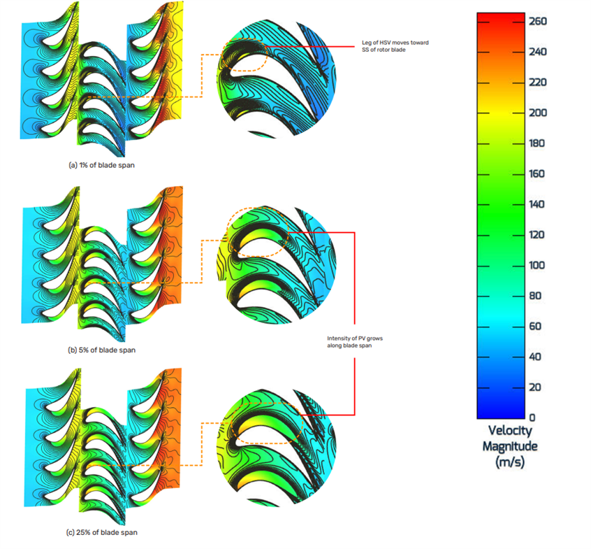

Contour plot of velocity magnitude at (a) 1%, (b) 5%, and (c) 25% of blade span

The different rows within the turbine require tailored mesh settings. Row 2, experiencing a rotational speed at 3,500 RPM, necessitates a finer grid to ensure accurate resolution of critical flow phenomena such as secondary flows and potential flow separation. In contrast, rows 1 and 3, characterized by steadier aerodynamic flow, allowed for coarser grids, optimizing computational resources without sacrificing accuracy. Meticulous attention to each domain's individual operational characteristics is essential for accurately reflecting real-world conditions within the model.
