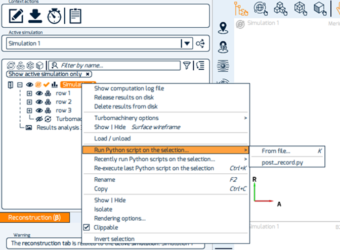

Launch Analysis with a Script: The post-processing process is initiated by running the `postrecord.py` script, which generates the necessary output and begins the analysis.
Reproduce Results with a File: The script generates a `results_analysis_state.py` file, which encapsulates a set of Python commands designed to replicate the post-processing setup. This ensures the reproducibility and consistency of output results across different simulation runs that utilize identical configurations.

Recording and Replaying Post-Processing States
Recording the Post-Processing State
To record the post-processing state, the Fidelity user runs the `postrecord.py` script. This script generates a `results_analysis_state.py` file in the project directory, which contains Python commands to fully reproduce the post-processing setup of the current simulation session.
Replaying the Post-Processing State
The Fidelity user is now able to leverage the captured state of analysis to restore the results analysis environment to a previous state by executing the recorded script, thereby streamlining the analytical process.

Ensure the `postrecord.py` script is executed while the intended post-processing configuration is active.
The `results_analysis_state.py` file can be used to automate repetitive tasks and workflows.
