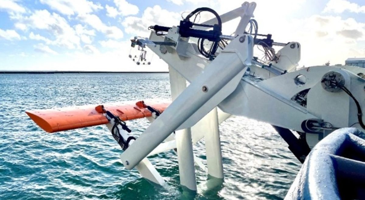

Bluefins develops zero-emission auxiliary propulsion solutions tailored to each type of ship, taking into account its architecture, safety, and other specific requirements or constraints. These propulsion systems are developed in partnership with the leading French research institute, Ifremer. The WaveDrive system, a whale-inspired propulsion system, consists of a hydrofoil attached to the stern of the ship and converts the pitching motion of the ship into thrust. This technology can be integrated into both newbuild vessels and existing ones during refit operations.

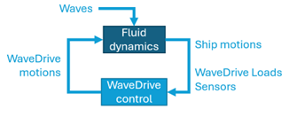

Bluefins leverages Fidelity CFD software to design and optimize the WaveDrive propulsion system under different operating and real-world wave conditions. The software's advanced features facilitate detailed analysis of the flap, the system dynamics, and the prediction of hydrofoil loads to optimize the propulsion.
These simulations mark a first step towards sensor-based control of the system’s motion under various sea conditions.

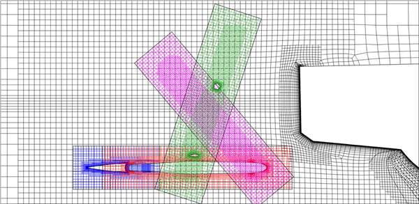

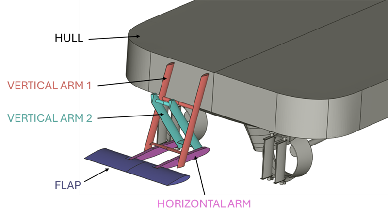

The mechanical system was decomposed into five distinct components; the half bodies of each component were meshed separately in Fidelity CFD version 2025.1. The hull was automatically meshed using the C-Wizard in Fidelity CFD, resulting in a high-resolution mesh with 8.8 million cells. The appendices were each meshed individually to be used as overset meshes.
Fidelity leverages the overset mesh method, using overlapping grids and interpolating data between them to accurately simulate complex flows and precisely manage the large motions of each component.
The initial cell size for the overset mesh was set to the sixth refinement level of the background initial cell size (ICS), while the background box refinement was conducted at one level coarser than the initial cell size. This setup featured three to four initial cell sizes at the overset interfaces to ensure accurate interpolation and seamless integration of the different mesh components. Overall, the hull had a total mesh size of about 10.6 million cells.

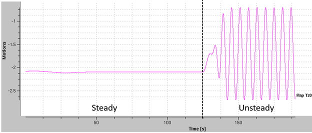

The image below shows the evolution of the flap’s position in the Z axis, with dashed line demarking the steady and unsteady runs.
