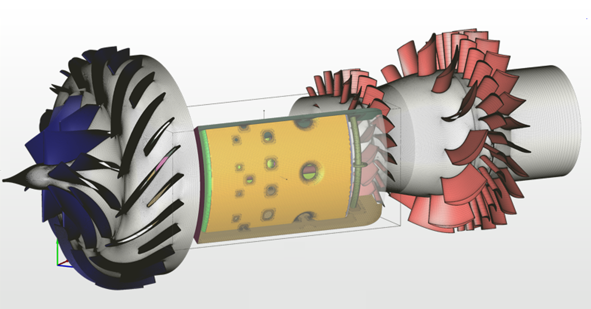

For blade-like geometries, users can apply a structured approach, and for non-rotating parts, like combustion chambers, volutes, etc, users can apply an unstructured approach, both available in Automesh (the unstructured module was previously known as Hexpress). As an example, a complete turbomachine is shown below (the complete simulation is detailed here). Each piece can be done separately, and the mesh generation itself in parallel. As such, 19 minutes are necessary if we can afford to run them at the same time.
Hence, we are seeing more and more users applying the best methodology depending on the geometry component. We can definitely identify a few others, like an impeller and its volute, a ship, and its propeller, etc.
