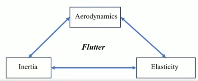

Flutter is a complex aeroelastic phenomenon characterized by rapidly growing oscillations within an aircraft structure. This instability arises from the interplay of aerodynamic forces, structural elasticity, and inertia. When the wings of an aircraft begin to flutter, it leads to these oscillations increasing swiftly. If the oscillations persist, they can result in significant structural damage.

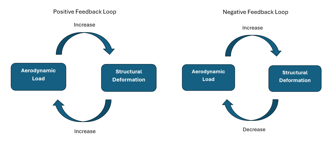

Feedback Loop Interaction Between Aerodynamic Load and Structure
There exists a positive and a negative feedback loop based on the interaction between the aerodynamic load and the structure. A positive feedback loop occurs when structural deformation leads to an increase in aerodynamic load. This increase further causes more deformation, which in turn elevates the aerodynamic load even more. This cycle continues until the aircraft experiences uncontrolled vibrations or oscillations. In some cases, vortex shedding can also produce unsteady loads that contribute to the positive feedback loop, leading to flutter.
Conversely, a negative feedback loop occurs when structural deformation results in a decrease in aerodynamic load. This reduction then decreases the deformation and, subsequently, the aerodynamic load, creating a stabilizing effect. This process continues until the aircraft stabilizes and regains control.
Aeroelastic flutter arises from the positive feedback loop, which causes the aircraft to enter a cycle of self-excited vibrations. As the amplitude of these vibrations increases with each iteration, so does the likelihood of structural failure. This risk is significantly heightened when the vibration amplitude surpasses the structural limits of the aircraft, which can lead to loss of structural integrity and catastrophic failure. Flutter can manifest at various speeds, depending on the aircraft's design and the conditions of the airflow, making it a significant safety concern. Therefore, conducting aeroelastic flutter analysis during the design phase is essential in predicting the loads exerted and ensuring the structural integrity needed to prevent flutter issues.

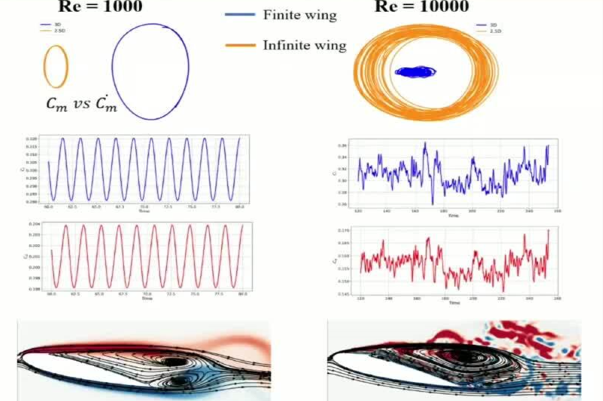

Impact of Reynolds Number, Velocity, and Amplitude on Wing Stability
The presentation reveals that when a wing undergoes flutter, oscillations increase significantly, potentially leading to structural failure if unchecked. For instance, as the Reynolds number increases from 1,000 to 50,000, the flow transitions from laminar to turbulent, with the boundary layer forming a laminar separation bubble followed by vortex breakdown. These changes correspond to increasing non-linearity and chaotic behavior in flow dynamics.
The reduced velocity, representing the ratio of free-stream velocity to the wing's pitching frequency, significantly impacts oscillatory behavior. Higher reduced velocities exhibit structured and stable flow fields, while lower reduced velocities intensify flutter instability. Similarly, larger amplitudes exacerbate turbulence and enhance the formation of coherent flow structures, such as hairpin and tip vortices, demonstrating the sensitivity of aerodynamic forces to the wing's oscillatory motion. Phase-averaged analysis further highlights the conditions under which lock-in and negative damping occur, confirming the onset of flutter.
