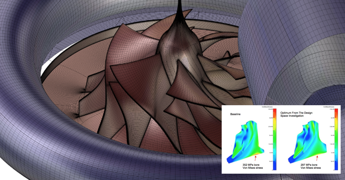

Ford Turchocharger Compressor CFD Mesh

The resulting mesh was then resolved by the FEA tool. In the present case a quite significant reduction of the stress levels was achieved, as shown in the Figure below.
Mechanical Optimization of a Ford Turbocharger Compressor
Results of the mechanical optimization
