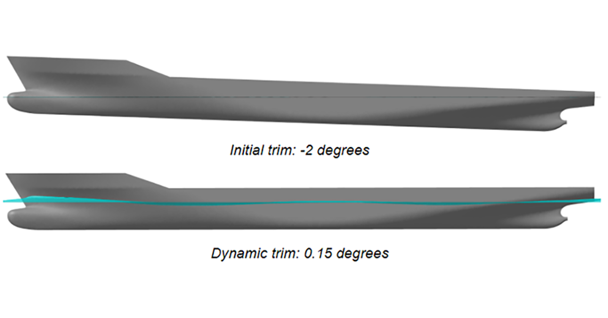

The Importance of Dynamic Trim
In the past, ship designs were optimized for one single speed and draft, even though most ships will experience a wide range of different conditions, requiring various changes to these parameters. Today, thanks to Computational Fluid Dynamics (CFD), a game-changing tool, matrixes of optimal trim and draft conditions can be generated quickly and with great accuracy.
Hundreds of simulations, one for each combination of initial trim, draft and speed, need to be run to create an optimal trim database, without the need for any model testing. Computations are performed at full scale, because using reduced models would not result in accurate prediction of turbulence, which affects optimum trim angles considerably. Local recirculation and flow detachment can lead to different force predictions between model- and full scale, as the Reynolds number, which governs these phenomena, cannot be preserved in the geometrical scaling. Compared to a potential code that doesn’t include the effects of turbulence, the resistance-increasing effects of wall-roughness (fouling) can be also included in the CFD analysis. As such, CFD can provide a much more realistic result of ship resistance during its entire lifetime.
