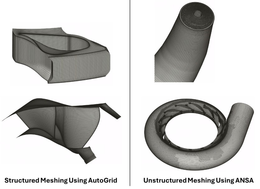

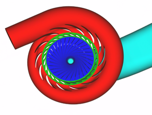

The Francis-99 turbine is a well-known benchmark case with experimental data available from workshop studies for validation against the CFD simulation results. The simulation uses a mixed meshing strategy to balance topological control and geometric flexibility. Structured meshes generated with Fidelity Autogrid are applied to the guide vanes and runner, where periodicity, blade shape, and high mesh quality are critical.
Unstructured meshes generated with Fidelity ANSA are used for the inlet spiral and draft tube, where geometry is more complex and a structured topology is less practical. This combination allows the solver to maintain accuracy in the blade passages while keeping the workflow manageable in the surrounding stationary components.

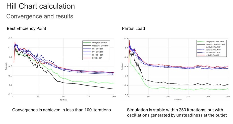

For steady-state simulation, the workflow is used to compute the hill diagram across multiple guide vane angles and rotational speeds. The results capture both the location of the best efficiency point and the shape of the efficiency isocurves in strong agreement with the available experimental data.
A slight overprediction of efficiency is observed, which can be attributed to disk-friction losses not included in the computational model. From an engineering standpoint, this is an important result: it shows that CFD can reliably reproduce global turbine performance trends while also clarifying which modeling assumptions influence the final comparison.
Under part-load operating conditions, the flow becomes increasingly unsteady, and the limitations of a steady-state approach become more apparent. As a result, transient simulations are required to accurately capture the complex flow structures and associated performance characteristics in these regimes.

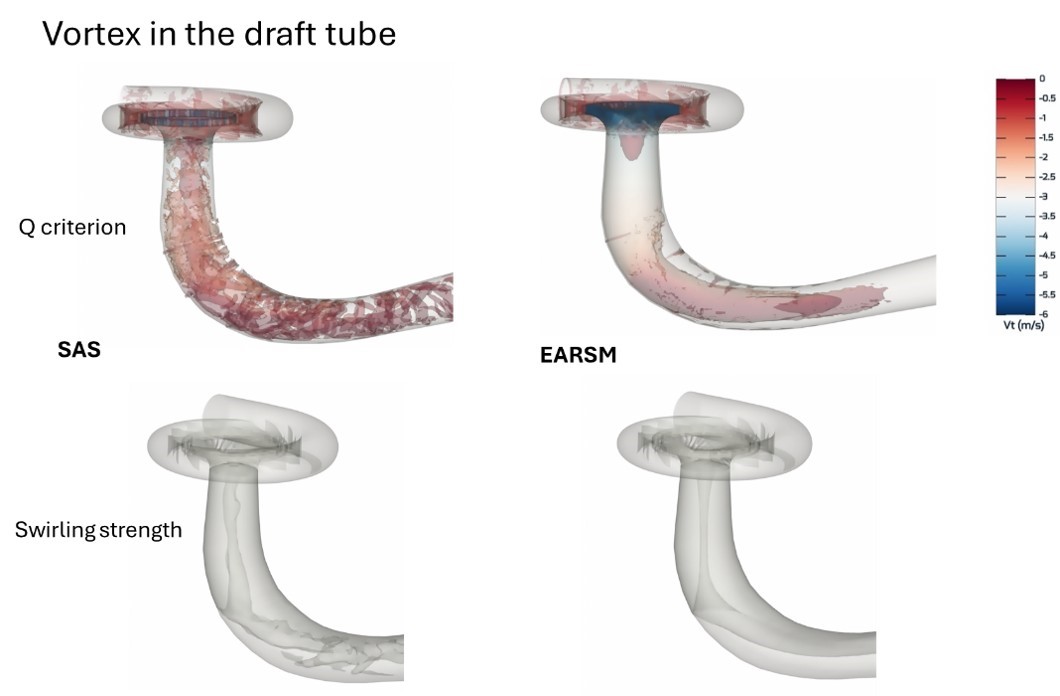

The study also compares three turbulence models—shear stress transport (SST), explicit algebraic Reynolds stress model (EARSM), and scale-adaptive simulation (SAS). While SST provides a strong baseline and the EARSM improves anisotropy representation, SAS is the only model that accurately captures large-scale unsteadiness, such as the vortex rope and its frequency in the draft tube.
Probe-based frequency analysis, along with Q-criterion and swirling-velocity visualizations, shows that SAS better resolves the coherent unsteady structure expected under partial-load conditions.

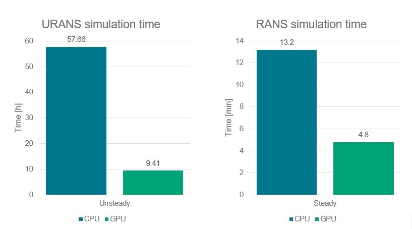

In this study, steady-state operating points were solved in minutes on the GPU, and even the unsteady Reynolds-Averaged Navier-Stokes (URANS) simulations—covering 40 full runner revolutions—were completed in about 10 hours, showing that both steady and unsteady hydraulic turbine analyses can fit within practical engineering timelines.

⇒ Why use a mixed structured–unstructured workflow in turbomachinery CFD?
A mixed workflow helps balance mesh quality, geometric flexibility, and simulation cost. Structured meshes are well-suited for blade passages where topological control and periodicity are important, while unstructured meshes are more practical for geometrically complex regions such as the inlet spiral and draft tube.

⇒ How do SST, EARSM, and SAS differ for turbomachinery off-design simulations?
SST is the standard baseline turbulence model and is widely used for steady-state performance prediction. EARSM improves the representation of turbulence anisotropy, which can be important in complex turbomachinery flows. SAS extends SST by enabling the resolution of large-scale unsteady structures, making it more suitable for capturing phenomena such as vortex rope behavior.
