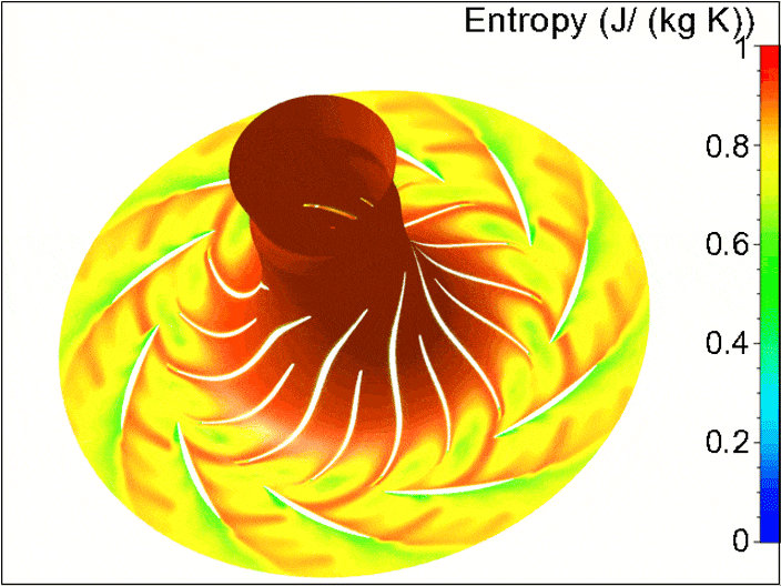

Entropy distribution in a centrifugal compressor

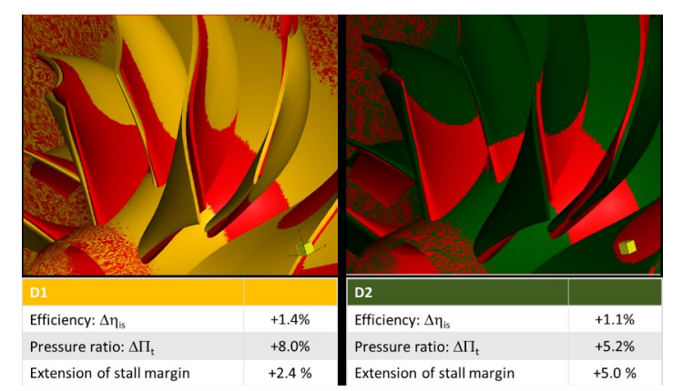

Results
The optimization process resulted in notable performance enhancements, as illustrated in the figure below. Two standout designs were identified, achieving all aerodynamic and structural goals. Specifically, design D1 achieved an 8.0% increase in the pressure ratio and a 1.4% rise in efficiency, along with an extended stall margin.
Comparison of original geometry and selected designs (D1 and D2)

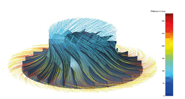

Second impeller streamlines
Fidelity Fine Turbo enabled the precise mapping of compressor performance, highlighting key areas for improvement. Design optimization using Fidelity Optimization focused on flow paths under varying conditions, introducing innovations like combined vane diffusers. A 40-million-element mesh model created with Fidelity Autogrid facilitated detailed simulations that confirmed design enhancements.

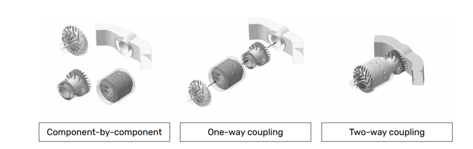

Traditionally, aero-engine simulations have been performed on a component-by-component basis, which can result in discrepancies with actual performance. Cadence's innovative methodology involves simulating the entire engine, employing two-way coupling without needing prescribed boundary conditions between components. This process enhances both accuracy and efficiency. The simulations included a steady-state Reynolds-Averaged Navier-Stokes (RANS) analysis and a more detailed Non-Linear Harmonic (NLH) simulation, utilizing a comprehensive 3D mesh, advanced turbulence models, and a simplified flamelet model for combustion.
Results
The results from the NLH simulation were particularly promising, as they captured tangential non-uniformities and provided a closer approximation of real-world engine behavior. This comprehensive approach resulted in consistent and efficient flow throughout the engine’s components, helping to achieve a more balanced engine performance.
Illustration of full engine simulation methodologies
