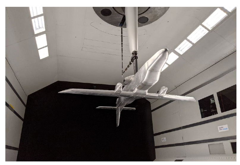

 Dornier 228 wind tunnel model installed in the RUAG LWTE (Pal et al., 2024)

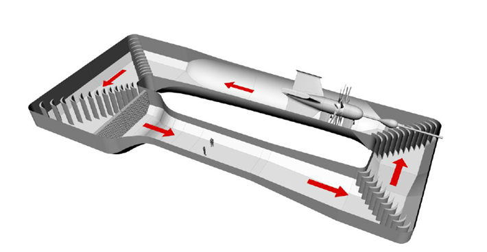

Wind tunnel tests were carried out in the RUAG Large Wind Tunnel in Emmen, Switzerland, using a scaled model of the Dornier 228 in high lift configuration. Measurements of lift, drag, and pitching moment were taken over a wide range of angles of attack, including conditions close to stall. Corrections were applied to ensure the results represented free-air behavior as closely as possible, and an uncertainty analysis was performed to assess the reliability of the data, especially near stall, where unsteadiness and nonlinear effects increase.
Large Wind Tunnel Emmen layout (Pal et al., 2024)

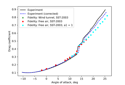

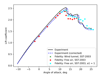

CFD results generated using a best-practice design assessment grid with Fidelity Flow Solver show good agreement with experimental data. Across the linear angle-of-attack range (−2° to +11°), lift, drag, and pitching moment coefficients agree within 1–5%, with slope differences of approximately 6% (lift), 3% (drag), and 10% (pitching moment). At critical and post-stall conditions, discrepancies increase to around 9%, reflecting the higher sensitivity of separated flows.
Lift coefficient as a function of angle of attack for the corrected and uncorrected wind tunnel data, as well as free air and in-tunnel CFD results (Pal et al., 2024)
Drag coefficient as a function of angle of attack for the corrected and uncorrected wind tunnel data, as well as free air and in-tunnel CFD results (Pal et al., 2024)

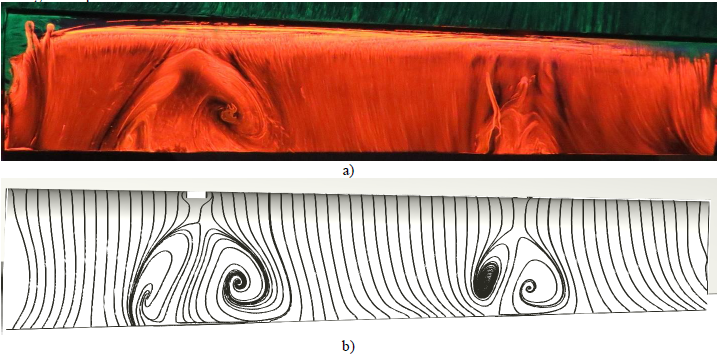

Local flow features on the aileron also correlate well with experimental observations. Despite minor differences in the flap and aileron deflection angles, CFD captures the location and extent of the separation and recirculation regions observed in oil-flow visualization. Additional postprocessing confirms that key vortical structures and recirculation patterns are consistent between wind-tunnel and free-air simulations, indicating minimal influence from tunnel wall and support interference.
a) Experimental oil flow visualization on the aileron; and b) surface streamlines based on viscous stress vector for the solution obtained with the Fidelity Flow PBS solver (Pal et al., 2024)
