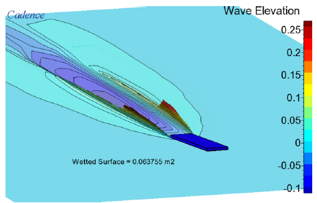

To move beyond the constraints of classical planing theory, the Zephir project leverages Fidelity Fine Marine to perform high-fidelity multiphase CFD simulations of the windsurf board under true planing conditions.
Fidelity Marine Solver makes it possible to:
  • Explicitly resolve the air–water interface
  • Accurately compute transient and localized pressure fields beneath the board
  • Capture trim, immersion, and free-surface coupling effects
  • Generate realistic boundary conditions for downstream fin analysis

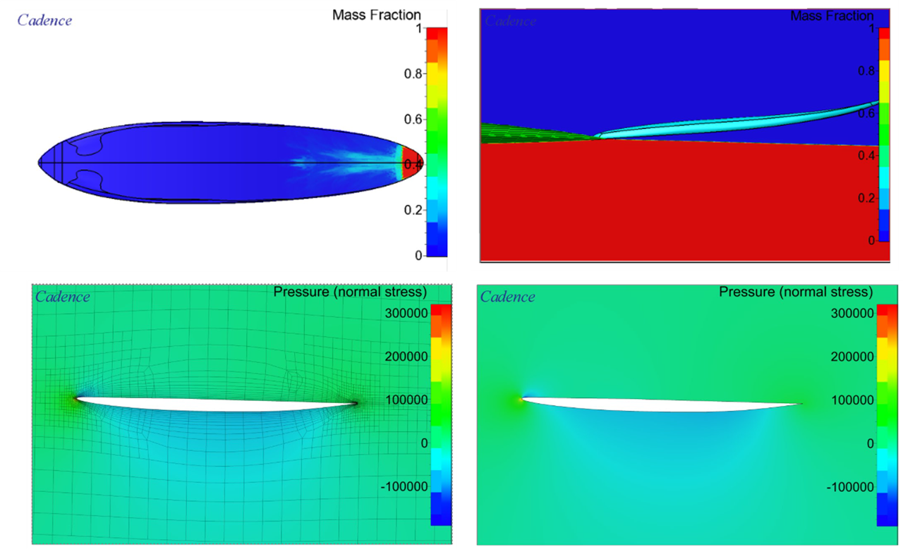

 Mass fraction and pressure field/contour around the windsurf
This workflow allows engineers to move beyond empirical safety margins by directly resolving the physics that limit performance. It enables precise identification of local pressure minima responsible for vapor formation, assessment of sensitivity to trim and angle-of-attack variations, and the design of fins that operate just below cavitation inception. As a result, operational margins can be quantified with confidence rather than inferred solely from experience.
