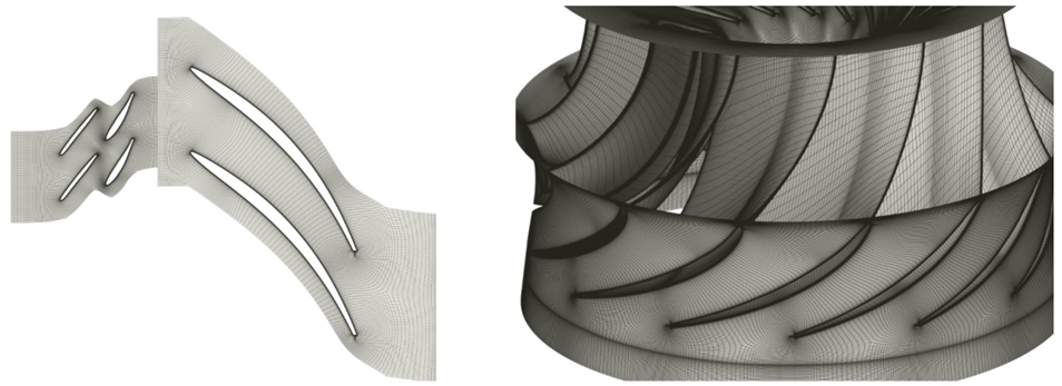

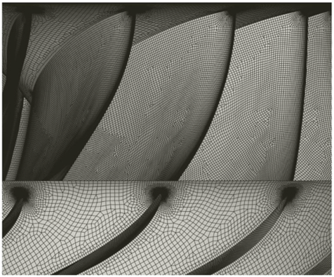

Fidelity Autogrid (Structured)
This approach uses a block-structured mesh with automatic topology and grid point distribution. It features high-quality blade-to-blade (B2B) smoothing, representing the conventional standard for turbomachinery simulations.

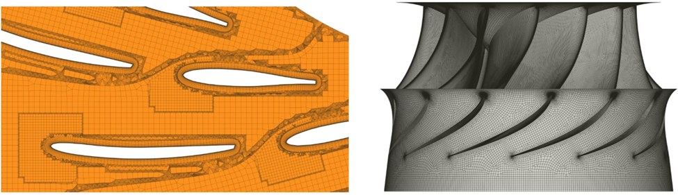

Fidelity Hexpress (S2V Unstructured)
This unstructured mesh is hex-dominant and features automatic periodic domain creation.
Key characteristics include:
  • Anisotropic refinements at the leading and trailing edges
  • Localized surface and volumetric refinements for precision
  • Matching periodic boundaries
  • An extruded boundary layer mesh
Unstructured Meshing using Fidelity Hexpress
The result is a high-quality unstructured mesh that showcases the efficiency of the S2V approach.

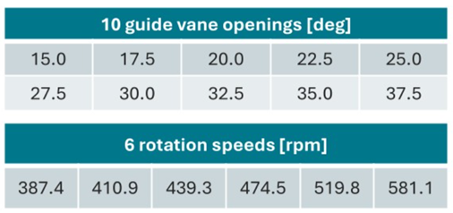

With the meshes prepared, 60 simulations were run to generate a full hill chart, covering 10 guide vane openings and 6 rotation speeds.

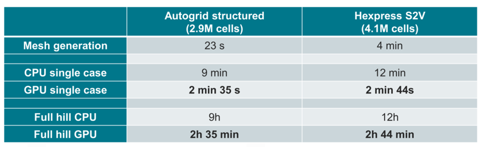

The simulations were run using the Fidelity Flow Solver under steady-state conditions with the k-omega SST turbulence model. This solver is an unstructured, cell-centered, second-order finite-volume solver. It is pressure-based and features full coupling of pressure and velocity, making it ideal for this type of analysis. For computing, high-performance computing with MPI-based parallelization and GPU acceleration was utilized.

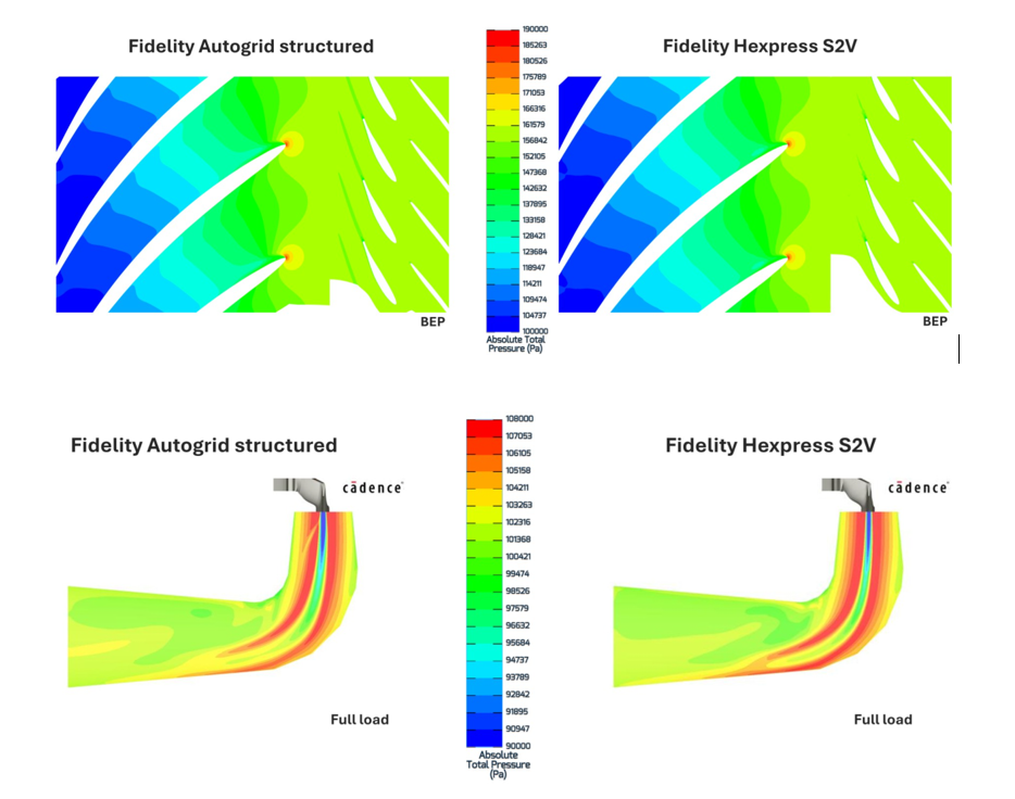

Numeric comparison between structured and unstructured S2V meshing
The Results: A Close Match in Accuracy

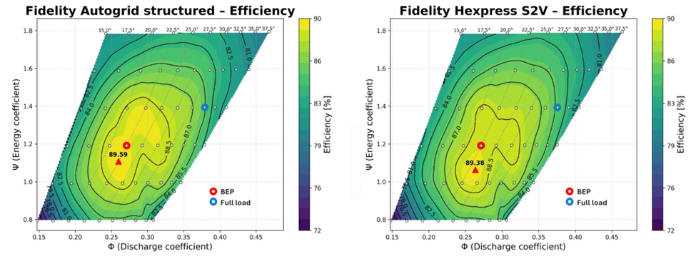

Efficiency comparison between structured and unstructured S2V meshing
After analyzing global values, the efficiency hill charts produced by both methods were remarkably similar. The peak efficiency difference between the Fidelity Autogrid structured meshes and the Fidelity Hexpress S2V meshes was a mere 0.2%.
This study demonstrates that the automated S2V meshing workflow produces results highly comparable to those of structured meshing, offering a compelling alternative for turbomachinery design cycles without sacrificing accuracy.
