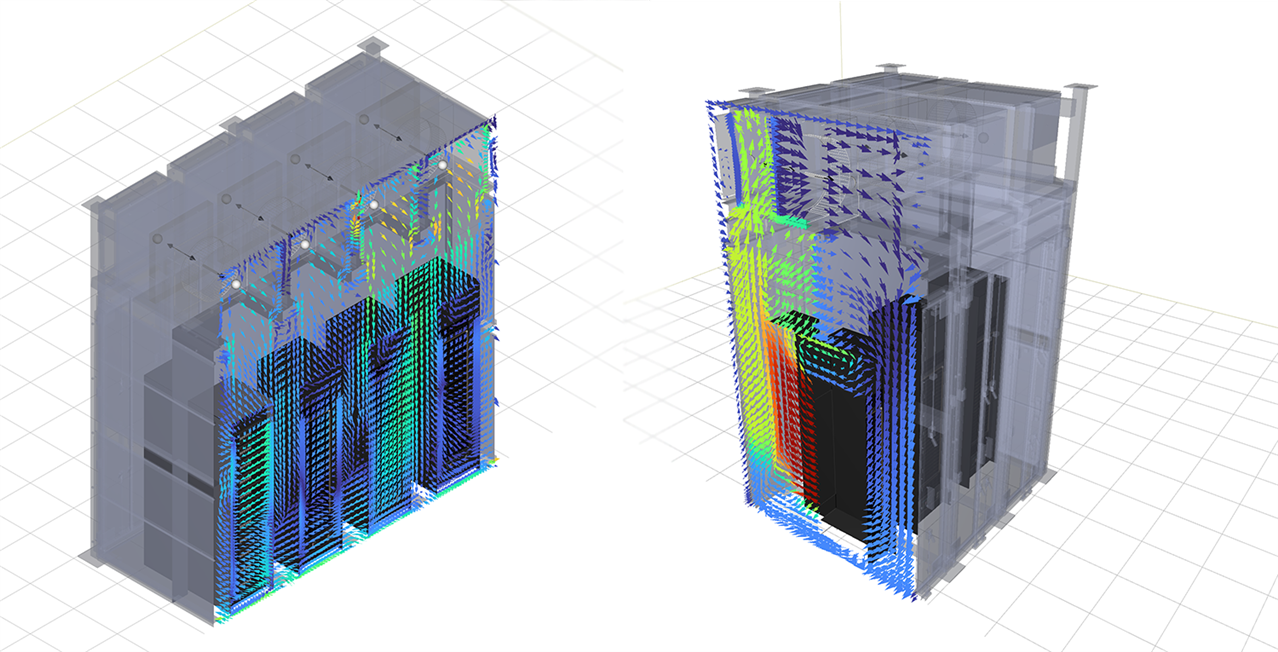

"We are redefining what is possible for next-gen AI factories with our patent-pending EVO Chamber solution—delivering up to 2MW per cabinet through advanced hybrid cooling in a modular, future-proof design. Using the Cadence Reality Digital Twin Platform, built with NVIDIA Omniverse libraries, Switch is developing a 5‑star DC Element—a physics‑accurate behavioral model and foundational building block for AI factory digital twins—of its EVO Chamber. This EVO Chamber Cadence Reality DC Elements model enables seamless design integration and rapid qualification of IT systems, including NVIDIA GB200 and GB300 NVL72 platforms, across a wide range of operating scenarios. Validation is performed using coupled physics‑based computational fluid dynamics (CFD) and flow network modeling (FNM) co‑simulation, allowing designs to be verified well before a single cabinet is installed."

This collaboration empowers organizations to de-risk and maximize token throughput for their AI investments through advanced simulation. The new Cadence Reality DC Elements model of the EVO Chamber allows engineers to drag and drop them directly into any data hall layout within the Cadence Reality Digital Twin Platform.
Once placed, these digital twins can be populated with specific cabinet payloads, including NVIDIA DGX GB200 and NVIDIA DGX GB300 systems. This is not a static model, but a physics‑based simulation of a real-world counterpart that predicts token‑production efficiency. By quantifying how power is consumed across compute and infrastructure, Cadence Reality Digital Twin Platform enables optimization of tokens per watt—maximizing power used for AI workloads within a fixed power envelope. This capability transforms facility planning from a static estimation exercise into a dynamic engineering discipline. Leaders can now answer critical questions with certainty:

One of the most significant advantages of this integration is the ability to validate complex cooling strategies in software. The Switch EVO Chamber details five separate fluidic system pathways designed to support both liquid-to-air and liquid-to-chip cooling strategies.
Aligning these pathways with modern direct-to-chip strategies for high-power GPUs is complex. Through the Cadence platform, operators can simulate and compare multiple cooling configurations side by side. This enables the optimization of performance, efficiency, and resiliency in a virtual environment, ensuring capital is deployed effectively and the physical facility is optimized from day one.
