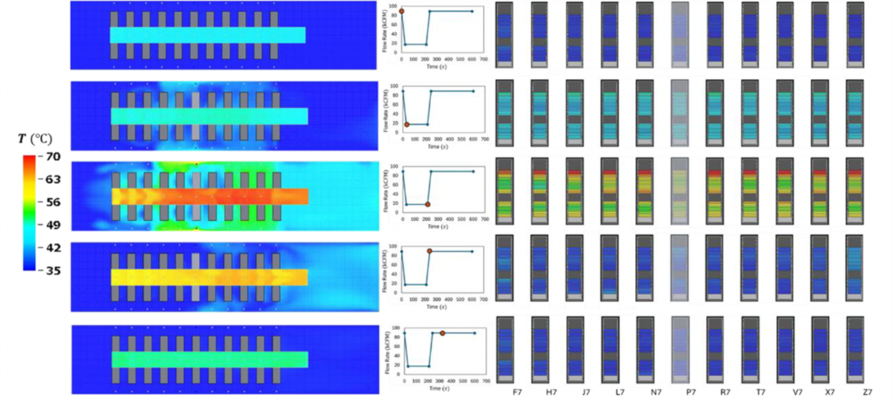

As hyperscale data centers evolve into AI factories, operators must manage non‑uniform rack power, airflow variability, leakage, and transient operating events. This Cadence – Microsoft research focuses on a foundational requirement for truly predictive digital twins: accurate, physics‑based CFD models that capture how air‑cooled data halls behave under both steady‑state and transient conditions. This was based on a generic hyperscale conceptual model.
Using detailed 3D CFD simulations in the Cadence Reality Digital Twin Platform, the study investigates air‑cooled data hall performance across multiple scenarios, including uniform and mixed-rack power densities, incomplete rack sealing, and airflow ramp‑down events. The work highlights how seemingly small effects—such as cabinet leakage or local pressure imbalances—can have an outsized impact on thermal reliability.
Key Findings from the Study
The analysis reveals several important behaviors that data center designers and operators must account for:
  • Venturi‑driven recirculation near AHUs: Racks located close to air‑handling units (AHUs) consistently experience reduced inlet pressure and elevated inlet temperatures as accelerated airflow induces hot‑air recirculation through cabinet leakage.
  • Network vs IT racks: some racks can particularly be sensitive to airflow imbalance and transient airflow reduction, showing the fastest temperature rise during low‑airflow events. Other racks can be less sensitive to these changes.
  • Impact of rack leakage: Even modest leakages (e.g., eight RU openings) enable bypass airflow that recirculates hot exhaust air back into the server inlets, degrading local cooling effectiveness without changing total airflow‑to‑power ratios.
  • Transient analysis: During airflow ramp‑down scenarios, temperature spikes occur rapidly, underscoring the importance of modeling dynamic—not just steady‑state—conditions.
