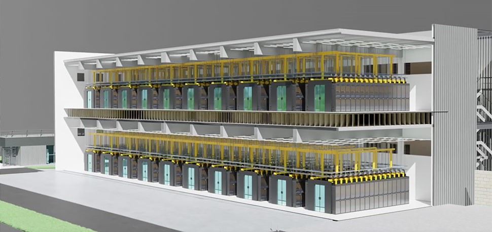

Digital representation of a data center
This economic shift sits atop a major technological transition. Large-scale AI training and inference workloads require dense GPU clusters, high-bandwidth networking, coordinated power delivery, and advanced cooling to turn electrical power into accelerated compute at scale. As a result, data centers are evolving from capacity-driven facilities into performance-driven AI production environments, where GPU utilization, latency, cooling efficiency, uptime, and tokens per watt increasingly determine the value delivered by the infrastructure.

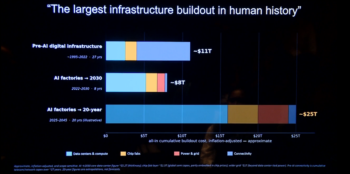

The infrastructure build-out for AI is being described as one of the largest in history, with projections suggesting tens of trillions of dollars in investment over the next two decades. At the same time, the amount of data being created, captured, replicated, and consumed worldwide continues to grow dramatically and is projected to surpass 700 zettabytes (ZB) by 2030, driven heavily by the rise of generative AI and machine-generated workloads. International Data Corporation’s (IDC) Global DataSphere research tracks this expansion, highlighting why the infrastructure supporting AI has to evolve beyond traditional models.
The largest infrastructure buildout in human history

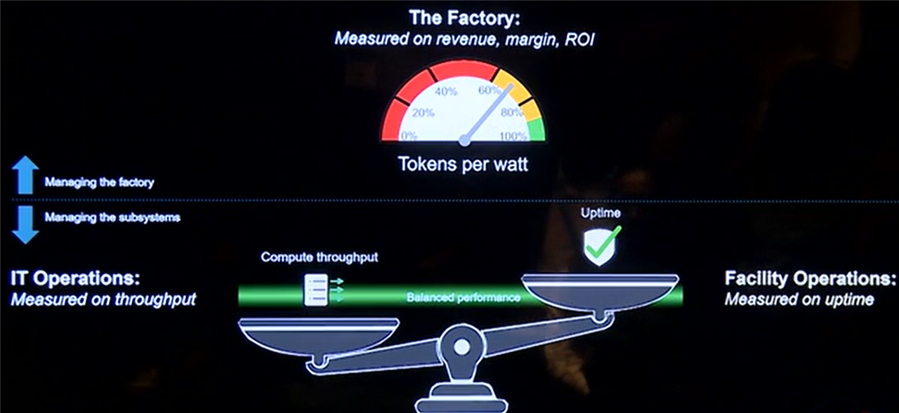

AI factories also change the economics of data center management. In a traditional one-megawatt data center, a 25% reduction in PUE could yield approximately $200,000 to $300,000 in annual energy savings, depending on local electricity costs. That is a meaningful operational gain. In a one-megawatt AI factory, however, the same efficiency improvement can be applied to additional token generation, potentially creating an estimated $7 million to $12 million in incremental annual revenue. The management question shifts from “How do we save energy?” to “How much more intelligence can we produce from every watt?”
That is why tokens per watt is becoming a more useful measure of AI infrastructure value. It connects electrical, thermal, and compute performance directly to business output.

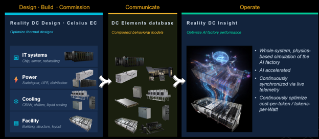

 Cadence supports this shift by combining accelerated computing, physics-based simulation, digital twin technology, and AI-driven optimization. The Cadence Reality Digital Twin Platform enables teams to model data center infrastructure from design and commissioning through operations, helping them evaluate decisions on power, cooling, and performance before physical implementation.
Cadence Reality DC Design, within the Cadence Reality Digital Twin (DT) Platform, and Cadence Celsius EC Solver support the design of data center components and systems. Cadence Reality DC Insight in the DT platform extends these capabilities into operations by automatically synchronizing the digital twin with telemetry and providing an optimization capability to manage performance, cooling, and capacity.
 Cadence data center solutions
Connecting design and operations is the Cadence DC Elements database, which provides behavioral models for data center components that can be selected and placed into a digital twin, like building blocks. If a required DC element is not available, Cadence will provide it as part of the software support agreement.
Cadence tools can also create AI surrogates of servers and complete data center environments, enabling physics-accurate results in near real time. In computational fluid dynamics (CFD), the physics engine underlying the digital twin, solving large-scale data center models, can be computationally intensive and time-consuming. AI surrogates accelerate this process, allowing teams to evaluate scenarios and obtain comparable results almost instantaneously.
