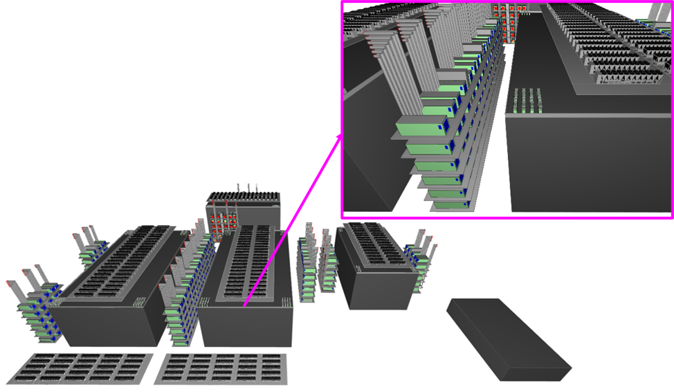

3D external view of a data center
At CadenceLIVE India 2026, Larsen & Toubro (L&T) presented a technical study on data center thermal management using the Cadence Reality Digital Twin Platform. The study reported 2X–10X productivity gains across preprocessing, simulation, and postprocessing while examining data hall airflow, chilled-water backup, electrical-room ventilation, diesel-generator heat rejection, and site-level exhaust recirculation.

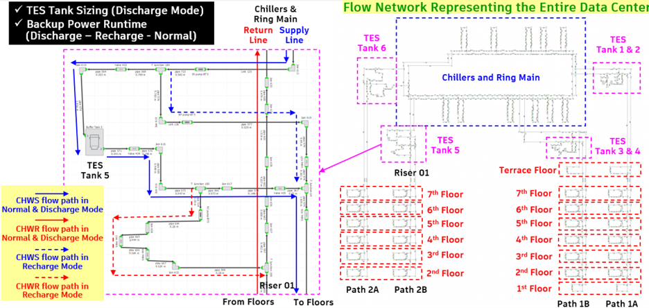

In the chilled-water analysis, L&T used a 1D flow network model in Cadence Reality DC Design to size the chilled-water system and verify the backup duration required before the facility could transition from diesel-generator power back to utility power. The model considered three operating modes: normal, discharge, and recharge. In normal and discharge modes, chilled water from the chillers is supplied to the data hall through the chilled-water system, and return water is routed back to the chillers.
In recharge mode, chilled water bypasses the main chilled-water system and is supplied directly to individual floors, while additional chillers recharge the thermal energy storage (TES) tank.
1D chilled-water flow network analysis for data center backup cooling

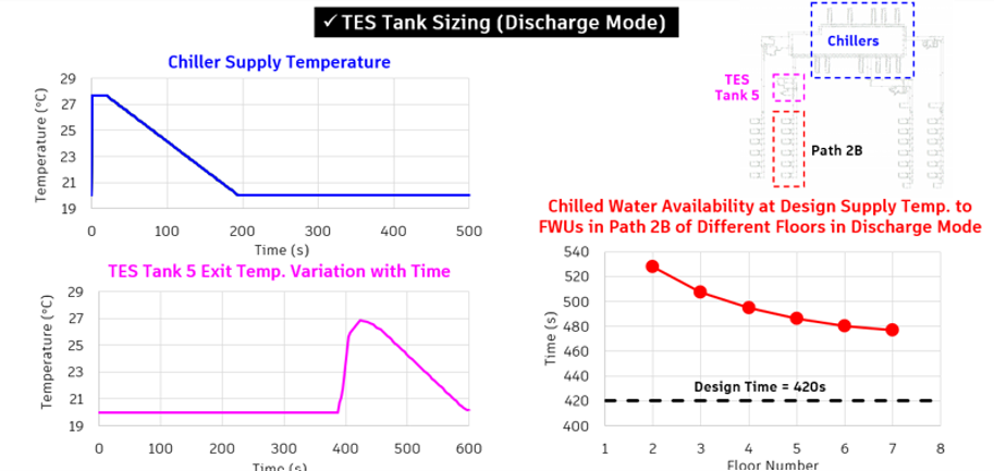

In discharge mode, the results show how long the chiller takes to resume supplying chilled water at the design temperature. In the simulation, the chiller returned to the design supply temperature in about 200 seconds, while the TES tank supplied chilled water for nearly 400 seconds during the transition.
TES tank sizing in discharge mode
1D chilled-water flow network analysis: TES tank sizing in discharge mode
The minimum requirement was 420 seconds of chilled-water availability at each fan wall unit (FWU). The 1D analysis showed at least 480 seconds of availability at each FWU, meeting the requirement with additional margin. Differences in backup time were driven by piping length; for example, floors with longer piping runs experienced a longer delay before chilled water reached the FWUs.

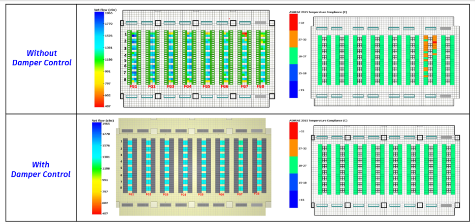

Air delivery inside the room introduced another design lever. In a separate raised-floor data hall with cold aisle containment, mechanically controlled floor grilles were evaluated for their ability to redirect cooling air where it was needed most.
Under uniform grille flow, rack inlet temperatures remained outside compliance. CFD results were then used to set damper openings that redirected airflow toward the racks that needed it most. The design reached compliance by redistributing available air rather than increasing total cooling capacity.
Raised-floor data hall airflow redistribution using damper control

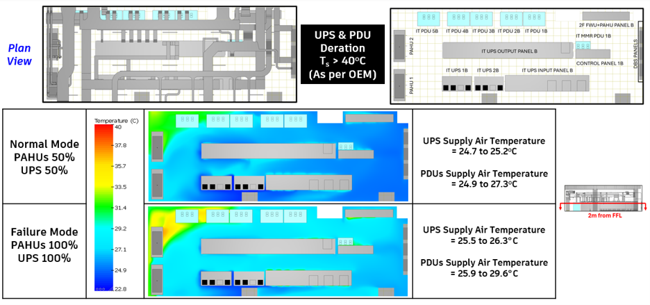

The same modeling discipline also applies beyond the IT white space. In electrical rooms, CFD was used to evaluate uninterruptible power supply (UPS) and power distribution unit (PDU) supply temperatures under normal and failure conditions. The maximum temperature was about 29°C, which remained below the 40°C OEM derating threshold. This showed that electrical-room ventilation could be assessed with the same thermal rigor used for server cooling.
Electrical room CFD analysis for UPS and PDU supply-air temperature

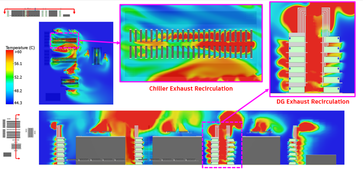

At the campus scale, external CFD supported a preliminary 270 MW data center master plan. The study examined chiller exhaust recirculation, the impact of diesel generator exhaust on chillers, and generator exhaust recirculation to understand how outdoor equipment behavior could affect thermal performance.
These effects depend on building geometry, equipment placement, exhaust direction, and wind conditions. The model helped evaluate mitigation options such as exhaust ducting, radiator discharge orientation, chiller containment, increased fan casing height, adiabatic pre-cooling, and alternative water-cooled configurations.
External data center CFD analysis for site-level exhaust recirculation
