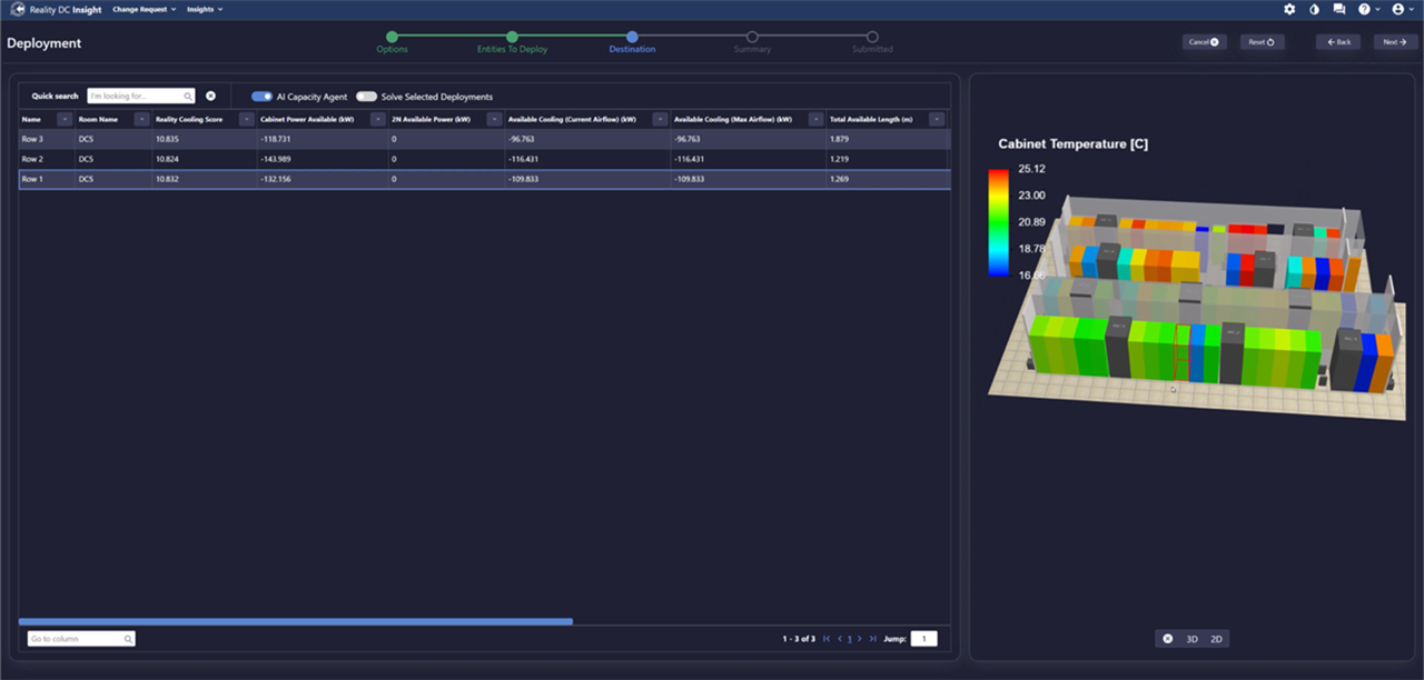

Figure 1: Cadence Reality AI Capacity Agent offers the best options for quick deployment.

Building on surrogate models and accelerated simulation, Cadence Reality introduces the AI Capacity Agent—a decision engine that continuously evaluates available capacity across the digital twin.
The agent assesses power, cooling, and space constraints using AI‑accelerated inference; ranks feasible deployment options based on performance, efficiency, and risk; escalates selected candidates to full CFD for validation; and generates comparison reports for side‑by‑side review.
This ensures that speed never comes at the expense of accuracy. AI narrows the field; physics confirms the final decision.
