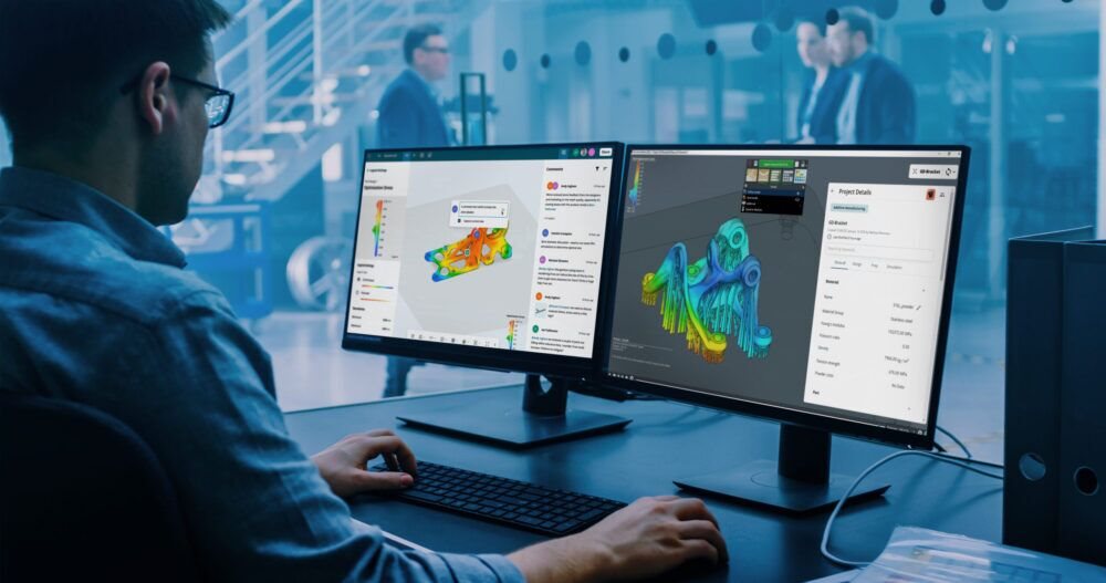

Nexus tip: Simufact Additive is a software tool that enables users to model and simulate various aspects of the additive manufacturing process. These include the build process itself, as well as post-treatment operations such as stress-relief heat treatment, baseplate cutting, support removal, and Hot Isostatic Pressure (HIP) treatment. To use Simufact Additive, users first import the outcome of AM-Studio, including the oriented part geometry and the associated support structure geometry.
Next, users define the actual process parameters for the build and post-treatment operations. Once the complete manufacturing process has been defined, the geometry is meshed, and the process simulation can begin. This simulation helps to identify potential manufacturing issues, such as the risk of cracks, support failure, recoater collision risk, and excessive distortions. Even with proper orientation and support structure, some distortion may still occur. To compensate for this, Simufact Additive can generate a new pre-deformed geometry based on the calculated distortion of the part.
This new geometry anticipates the distortion generated by the 3D printing process and produces a part that falls within tolerance. The software also enables automated global compensation based on a best-fit approach.
For more complex compensation schemes, VGSTUDIO MAX allows users to perform advanced iterative global and local compensations and verify the quality of the result based on the actual product manufacturing information and associated geometric dimensioning and tolerancing (GD&T) plan of the part
