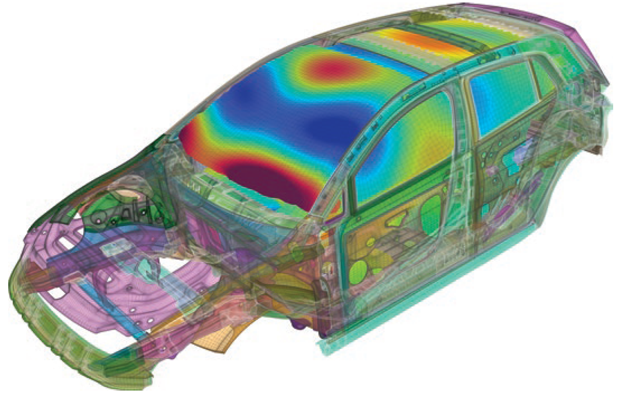

Vehicle interior noise comfort NVH simulation
Figure 1: Cabin sound quality is the endpoint every full-vehicle NVH study works back from.

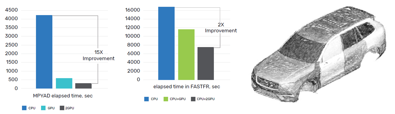

The Benchmark
The reference benchmark for this comes from results presented in "A Deep Dive into NVH Analysis Using MSC Nastran": a 43.5 million-degree-of-freedom automotive body model, solving 50,000 eigenmodes across 1,500 frequencies. With GPU-accelerated FastFR, the configuration showed up to 50 percent faster runtime on the runs that extended to high frequency. Broken down by operation, the dominant matrix-multiply step showed roughly a 15X improvement, and the FastFR stage overall came down by about a factor of two on the reported configurations, with further gains moving from one GPU to two.
The pattern inside those numbers is the part worth carrying into a program decision. The benefit grows with the frequency range. The higher you push the analysis, the more modes and frequency points enter the calculation, and the more of the runtime lands on the operations the GPU accelerates. The runs that used to be the most painful are the ones that speed up the most.
FastFR in MSC Nastran on Volvo Car
Figure 2: GPU-accelerated FastFR in MSC Nastran on Volvo Car Corporation's 43.5 million DOF body model, solving 50,000 modes across 1,500 frequencies.

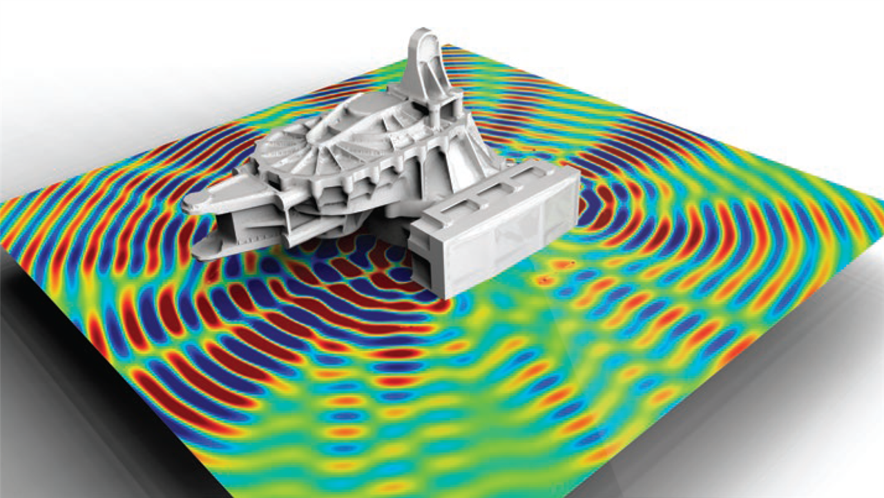

This is not an incremental convenience for electric vehicle work; it is aimed at the exact regime EVs create. Motor whine and inverter harmonics reach into the kHz range, which means more modes and more frequency points in every full-vehicle run, precisely the conditions under which GPU acceleration returns the most. A team that has moved its NVH targets upward in frequency to chase e-drive tonal noise is running the workload that benefits from this the most, not the least.
e-powertrain housing NVH simulation
Figure 3: Electric drive units concentrate NVH energy where it is hardest to compute. High-frequency electromagnetic forces excite the housing up to 11 kHz, and the surrounding coolant couples strongly with the structure.
