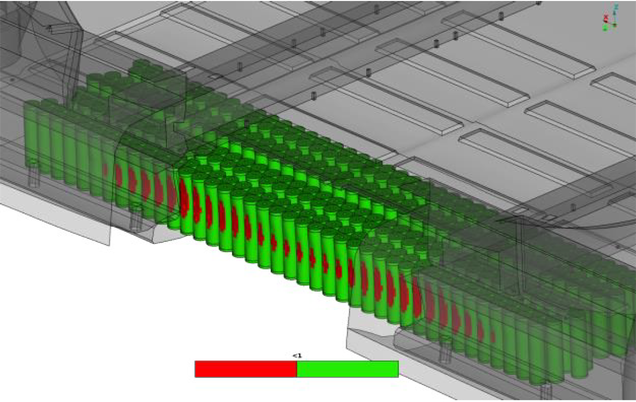

Damaged battery cells in a 60 km/h side impact against a rigid pillar
Figure 1: Damaged battery cells in a 60 km/h side impact against a rigid pillar. The internal short criterion triggers above a stress threshold, making the damaged cell count a discontinuous response, harder to predict than mass.

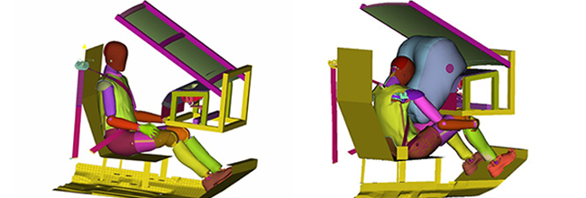

Dataset size does not track the number of design variables. The EV rocker study had the simplest parameterization in the group, just two plate thicknesses and a plate location, and it needed four times the experiments of the 25-run occupant safety study, which varied restraint system parameters, including dummy to seatbelt friction, seatbelt sensor time, and slipring position.
It does not track model size or load case severity either.
The 25-run occupant safety sled test. A THOR-50M ATD restrained by seatbelt and airbag.
Figure 2: The 25-run occupant safety sled test. A THOR-50M ATD parameterized on restraint variables, not geometry: slipring position, dummy to seatbelt friction, airbag venting, and sensor trigger times. Left, slipring position. Right, airbag interacting with the occupant.

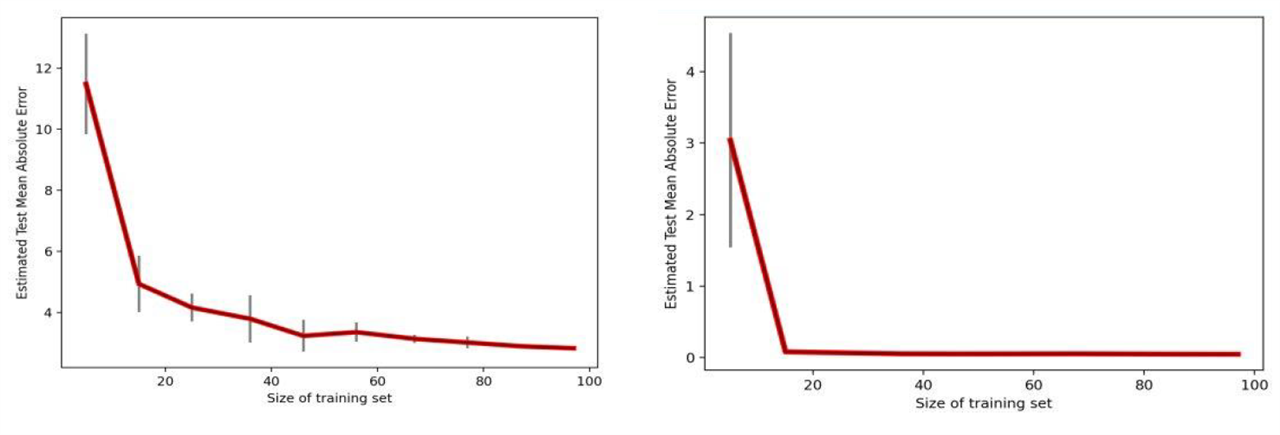

Rocker mass returned a predictive power score of 0.98. Number of damaged battery cells returned 0.64. The learning curve in that study, plotting training dataset size against accuracy, showed mass converging on far fewer experiments than damaged cells.
Figure 3: Dataset size vs prediction accuracy. Mass reaches usable accuracy on a fraction of the runs the damaged cell count needs, from the same dataset and design variables.
The reason is visible in the physics. Mass is a smooth, near-monotonic function of plate thickness. The number of damaged cells is an integer count produced by a threshold, since an internal short is triggered when stress on a cell exceeds a defined value. A response that counts threshold crossings is discontinuous by construction. Small geometry changes either flip a cell over the threshold or they do not, and the predictor has to learn where all of those boundaries sit.

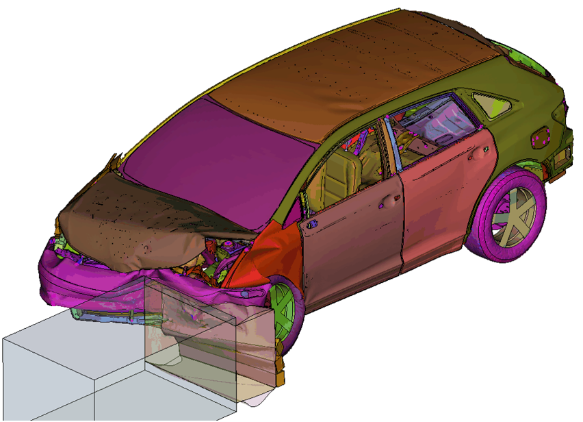

The front crash study points the same way from a different angle. Validated against the FE analysis, predicted intrusions came in between 0.9 and 12.6 percent error. Predicted accelerations at the seat fixation points were consistently worse, up to 16.8 percent. Intrusions are displacements. Accelerations are second derivatives, with far more high-frequency content. Same model, same dataset, same predictors, and the smoother response class predicts better.
Frontal offset impact in the 60-run front crash study
Figure 4: Frontal offset impact in the 60-run front crash study. Predicted intrusions fell within 0.9 to 12.6 percent of FE; seat fixation accelerations reached 16.8 percent.

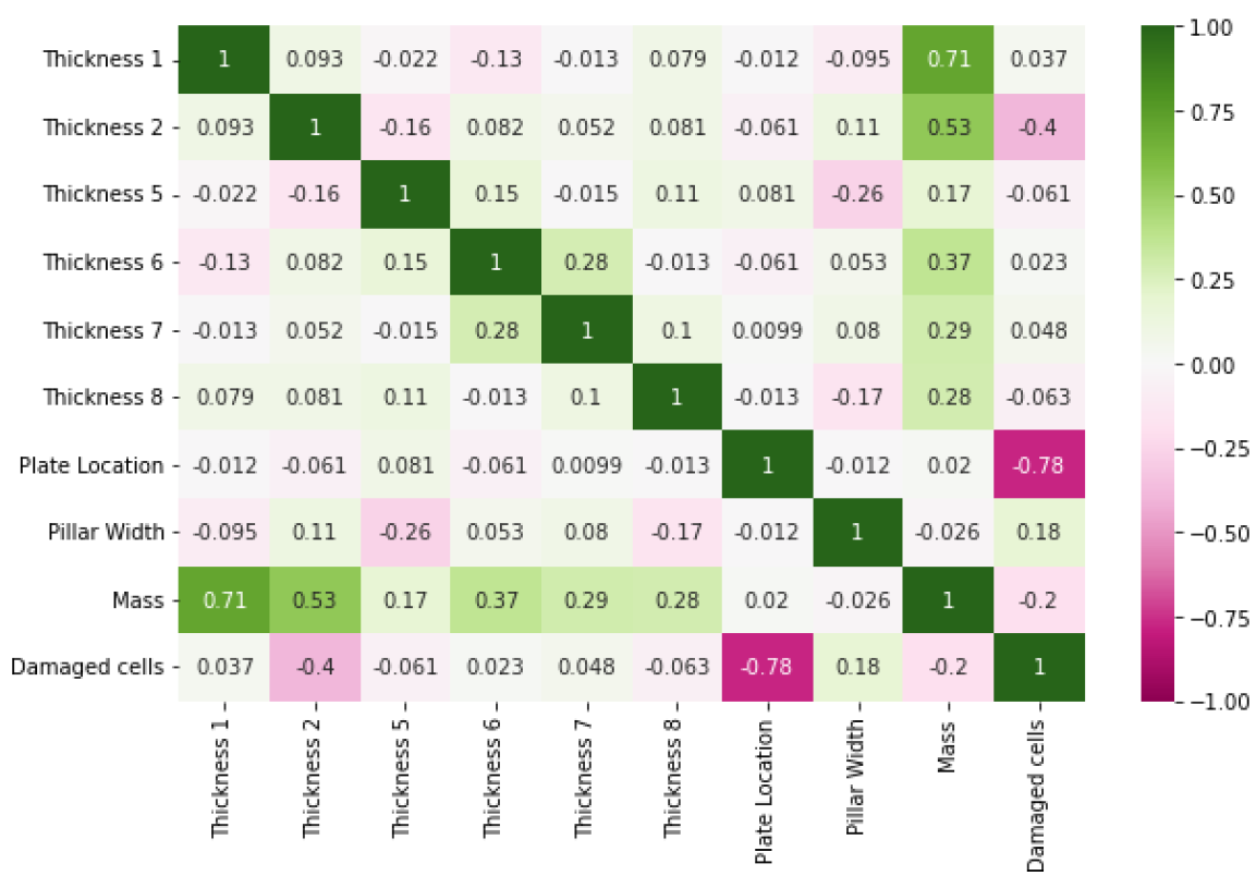

Inspect the data before you train anything. The correlation matrix and pair plots show which design variables actually move which responses. The predictive power score, which detects both linear and non-linear relationships on a 0 to 1 scale, flagged the difficulty gap between mass and damaged cells in the EV rocker study before a single predictor existed.
Correlation matrix for the EV rocker study
Figure 5: Correlation matrix for the EV rocker study. Mass is driven mainly by the two plate thicknesses, damaged cell count mostly by plate location, and thickness 2. Available before any predictor is trained.
Read the learning curve, not the accuracy figure. The relationship between dataset size and accuracy tells you whether another twenty runs will help or whether you have plateaued. That is the difference between spending solver budget and wasting it.
