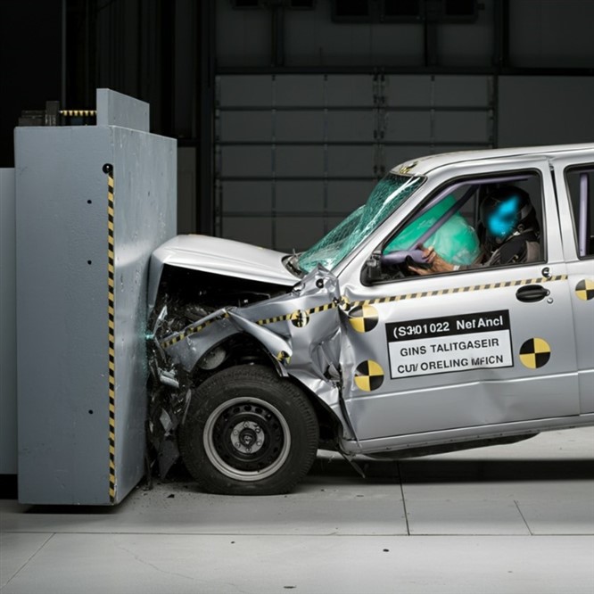

It’s a meticulous test in which vehicles equipped with sensors and cameras are used alongside crash test dummies (anthropomorphic test devices (ATDs)) that mimic human responses to crashes. The data gleaned from these tests are indispensable, providing insights into a vehicle’s structural integrity, restraint systems, and overall safety, guiding vehicle design enhancement.

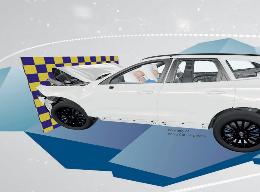

Automotive crash testing assesses vehicle safety through methods such as physical crash tests, which involve recreating collision scenarios with instrumented dummies; sled testing, an economical approach focusing on seat belts, airbags, and whiplash prevention; and computer simulations, which use advanced software to model vehicle dynamics and safety features during crashes.
Picture Courtesy: Volvo Car Corporation
The results from crash tests provide extensive data, including the timing of airbag deployment, assessments of head impact and injury potential, evaluations of seat belt integrity and tension, analyses of vehicle deformation post-collision, and comparisons between outcomes for belted and unbelted occupants.

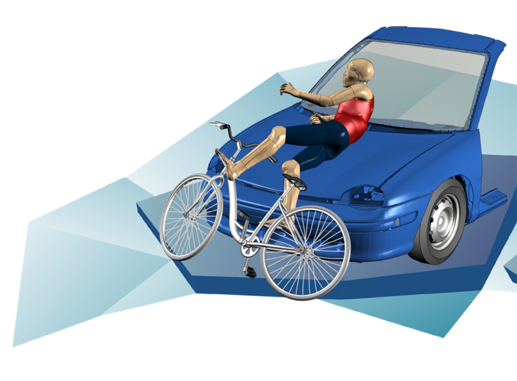

Emerging as a game-changer, computer simulations through FEA bring a new dimension to crash testing. FEA enables the detailed virtual modeling of a vehicle, subjecting it to various crash scenarios without the need for physical prototypes and facilities for destructive testing. This slashes development time and costs and allows engineers to explore a broader range of test conditions and design iterations. By predicting how different car parts react under specific stresses, simulations facilitate more informed design choices, significantly enhancing safety before a physical prototype is even built.

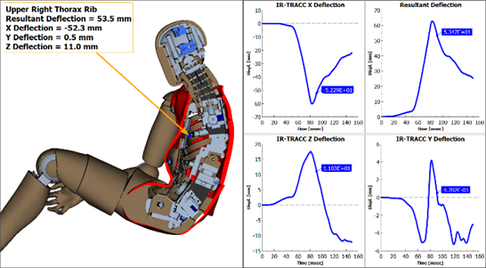

In parallel, occupant injury criteria extracted from results obtained in different digital ATDs, provide deep understanding on how the human body responds in different crash scenarios. These findings are instrumental in advancing our knowledge of vehicle safety, enabling the development of more effective strategies and innovations to better protect passengers during collisions.
