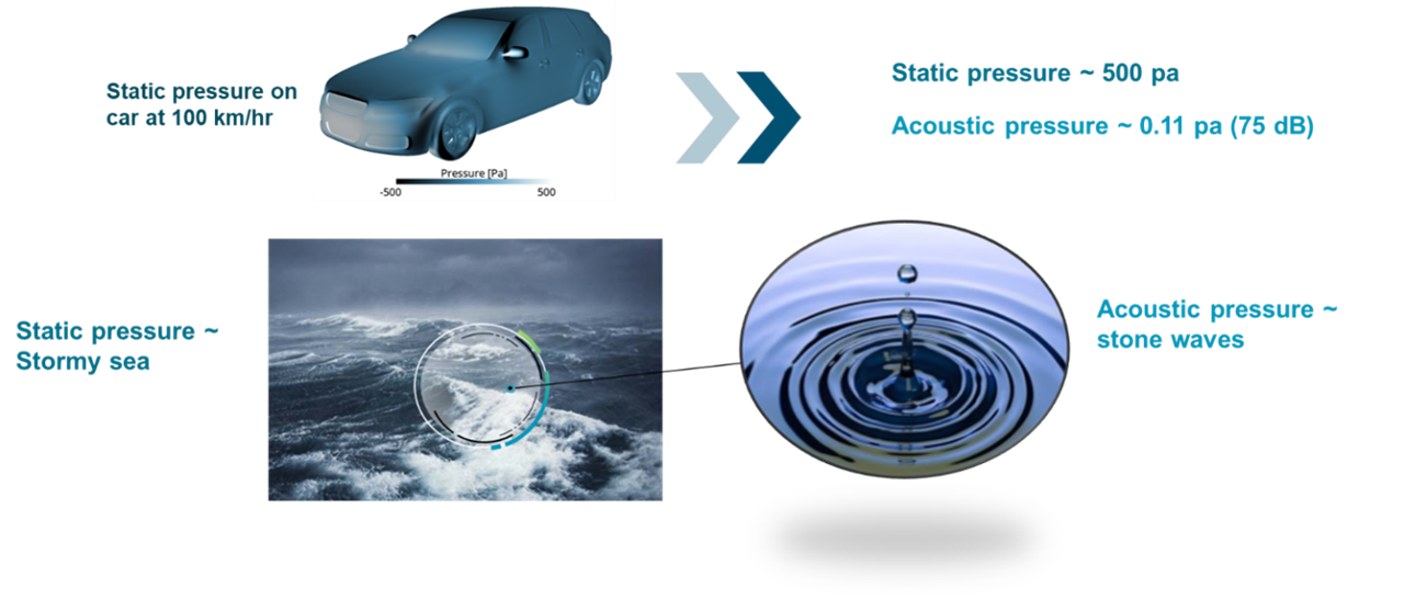

Why Simulating Aeroacoustics Is Not as Simple as Reading CFD Pressure
At first glance, aeroacoustics may seem like a straightforward extension of computational fluid dynamics (CFD). If a simulation already computes pressure and velocity, why not just look at the pressure field and identify the noise?
The challenge is scale. The acoustic pressure associated with sound is extremely small compared with the aerodynamic pressure fluctuations created by turbulent flow. For example, a sound pressure level of 75 dB corresponds to a pressure fluctuation of roughly 0.11 Pa in air, while the flow around a vehicle at highway speed can involve much larger aerodynamic pressure variations. Finding the acoustic signal inside that flow field can be like trying to hear a pebble drop in the middle of a stormy sea.
That is why aeroacoustic simulation needs more than a basic pressure plot. Engineers must decide how much flow detail is needed, how acoustic sources should be extracted, and how sound should be propagated to the listener or receiver location.
