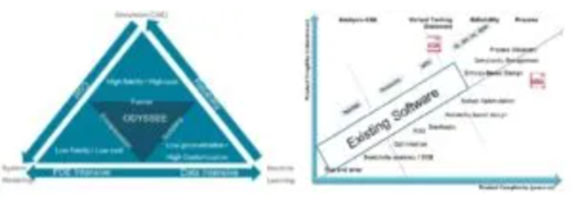

Since then, this area has still not really been democratised and the CFD world has continued on relatively unchanged until Hexagon acquired CADLM in April 2021. CADLM is a fast-growing Paris-based ‘AI and ML for CAE’ simulation company run by Professor Kambiz Kayvantash. What Hexagon has done is to quickly take CADLM’s tried-and-proven general-purpose AI/ML algorithms for CAE embedded within their product suite called ODYSSEE CAE, and, along with a recently released product called ODYSSEE A-EYE extended even more into AI applications. These products both include and extend beyond trusted design space techniques like design of experiment (DoE), process integration and design optimisation (PIDO), and design space optimisation (DSO) that all have their place in CFD / CAE simulation workflows today; but they are well over ten-year-old methodologies and technologies now. The diagram below shows the way modern AI/ML algorithms can be viewed in the context of this spectrum of DoE / PIDO / DSO tools. Indeed, ODYSSEE CAE includes all capabilities to the left of machine learning on the diagram, as well as new and exciting capabilities and algorithms tailored for the CAE and manufacturing worlds. ODYSSEE A-Eye can fuse data from different sources such as virtual CAE simulation, real world scanning data, and even photos and video images; plus financial and costing data can even have ML and AI analysis applied in order to derive actionable outcomes very quickly! You can read more of how AI/ML has impacted metal forming simulation and costing inside Hexagon in this recent FormingSuite magazine article by my Canadian colleague, Mike Lee.
ODYSSEE can actually measure the complexity of a model, a system or a process and uses a concept related to entropy in chemistry for robust optimisation of capabilities such as cost engineering in ODYSSEE A-Eye. Reducing complexity equates to increasing robustness in CAE models of any other process. ODYSSEE software can even fuse multiphysics ROM (reduced order model) data from different CAE solver types that typically would require very different timescales to converge due to the numerical intensity of their mathematical techniques – 3D FEA structures, 1D MBD, 3D FV CFD – in near real-time. This is a game-changer for the CFD and CAE industries in my opinion by virtue of unleashing new levels of productivity without losing quality and opens the prospect of operational digital twins that can democratise trained CFD and CAE simulations to non-experts such as plant operators. Hence, tens of millions of engineers and plant operators, and even the general public, could benefit from realtime CFD and CAE simulation!

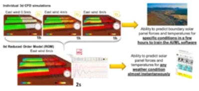

In this example, Hexagon created a 3D Cradle CFD model of our new Hexagon | R-evolution subsidiary’s Archidona Solar Farm in SW Spain  by capturing Hexagon’s Leica BLK247 real world scanned data of the actual as-installed solar panel tracks on our 8 MWp solar farm. We took this real data into a Cradle CFD geometrical model of the plant and incorporated 3D geo-scanning data for the landscape around Archidona so we could fuse the real and virtual data. We then carried out a series of meteorological simulations for the solar plant, and solar panels oriented at different angles to the vertical on a rotating single axis to represent their typical movement. Each full 3D Cradle CFD simulation took 1 hour to solve in the 3D Cradle CFD model on a large desktop machine but once a full CFD digital twin of the solar farm and panels was created inside ODYSSEE CAE, all sorts of “what if..?” questions could be determined for optimal operation of the solar plant on a laptop; typically only taking 2s per simulation.
This approach now allows us to couple real-world weather forecast data to next-day solar farm operations in an actionable way to optimise electricity generation with our thermo-fluid operational CFD digital twin of the site. It can therefore be directly linked to actions that maximise power generation efficiency on site and the profitability of the site. Ultimately, we have a powerful tool to educate solar farm operators onsite with real-time augmented reality CFD visualisations that they can hold up in front of themselves to understand what is happening in a thermo-fluid sense. This was done by coupling Hexagon’s powerful XALT dashboarding technologies to Cradle CFD simulation predictions to provide a powerful AR visualisation of the solar plant in real time on an iPad or on an iPhone with the upcoming Cradle CFD 2022 product release this month. This fusing of real world as-installed and as-operated solar farm scanned data and our virtual Cradle CFD prediction data in a CFD digital twin is, we believe, a world first and a new Smart Digital Reality that gives Hexagon a unique means of optimising the performance and outputs of our solar farm on a daily basis.

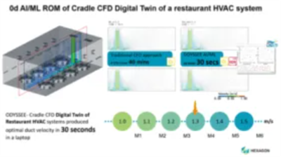

In this second example, we were investigating the optimal location in a restaurant to position HVAC air flow vents to ensure good mixing – especially now in the era of COVID-19 – plus we wanted to determine the optimal duct vent flow rate. This is inherently a transient non-linear CFD simulation, and the complete 3D simulation took 40 minutes to solve on a 4-core desktop machine for one operating condition. A series of bounding 3D CFD simulations were then run and used to train ODYSSEE CAE for this application. The 0D ODYSSEE ROM model interpolated the CFD predictions to provide almost the same level of fidelity as the 3D CFD simulations in just 30 seconds for other conditions and helped to determine the optimum air flow rate for this restaurant, table layout and vent scenario.
