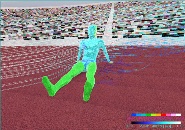

The model we used calculates the temperature of an athlete’s skin, the core temperature and the degree of perspiration. In our experiment, we divide the body into 17 areas and overlay a separate model which simulates the circulatory system, accounting for age, gender and body size.
Bringing these two models together, we recreated the 10,000 metres in the hot, humid conditions of a Tokyo summer. We focused on the longest track race in the games, but the results are relevant to all athletes, particularly those competing in high endurance activities during the hottest part of the day.
The Two Scenarios
To create some really useful data, we modelled the event in two contrasting scenarios. The first simulated hotter than average conditions at 32°C or 89.6°F with a humidity level of 90%. The second, average conditions, we ran at 27°C or 80.6° F and 70% humidity. Both were with negligible wind speed since the event takes place inside a stadium.
The results provide important information for athletes, trainers, and organising bodies. Taking part in the 10,000m endurance race in average conditions, a runner’s core temperature is likely to just reach the danger zone of 39°C or 102.2°F, with the hands and feet at 37°C or 98.6°F.
The simulation for severe conditions tells a much more startling tale. In this case, the competitor’s core temperature reached 39.7° or 103.46 °F, well into the danger zone. Even more worrying was the core temperature of the runner’s head, which reached 39.2°C or 102.56°F, increasing the danger and severity of heatstroke dramatically. These simulations show that an increase by just a few degrees is enough to put athletes at risk.
