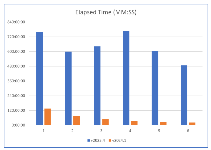

Overall Model Performance: The blue line indicates no AMSR used, whereas the orange line indicates AMSR used in the run. The x-axis numbers represent SMP scaling (Serial, 2, 4, 8, 16, and 32) for the same model.

In recent large‑scale industrial benchmarks, as well as the case study presented above, we notice that:
  • Large, expensive FBS module avoided
  • Speed-up factors in overall runtimes range from 20-40x when AMSR is enabled compared to older workflows without AMSR
  • Database I/O significantly reduced (in the example above, from 3.4TB to 139GB)
  • Scratch database required significantly reduced (in the example above, from 1.7TB to 123GB)
  • Newer MSC Nastran releases deliver similar AMSR performance with fewer threads than earlier versions, thanks to continued optimization.
