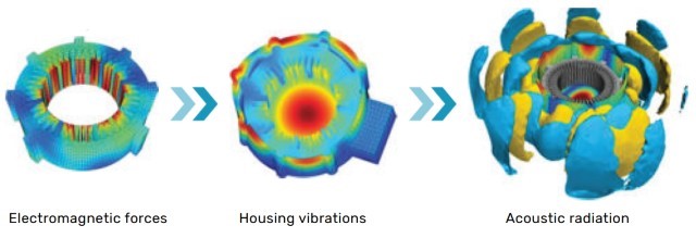

The multiphysics chain for e-motor NVH, mapping internal electromagnetic excitation forces to structural housing vibrations and downstream acoustic radiation

Motor whine analysis in an EV illustrates the challenge. Electromagnetic forces in the motor can excite the stator, housing, mounts, and surrounding structure, which then radiate into the cabin as sound. A small change in motor geometry, inverter switching, housing stiffness, or mount design may improve one metric while creating a tonal peak audible to passengers.
