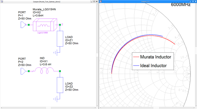

For example, comparing a Murata inductor model with the same constant (3.6 nH) and an ideal inductor model, we can see that there are differences between the two. This is because an actual inductor component has parasitics that change their performance from the ideal response. Taking these parasitic effects into account is necessary to ensure design success.
Figure 1. RF response of a Murata SMD Inductor (shorted to ground) vs an ideal inductor shows the impact of parasitics on high-frequency performance.

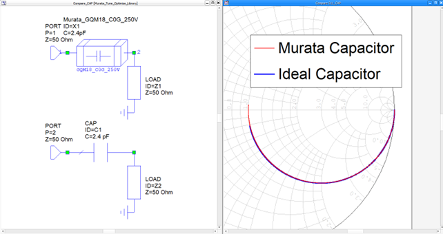

There are also differences between ideal and actual component models for capacitors. In addition to capacitance, real components have parasitic components such as equivalent series inductance (ESL), which also affects impedance at high frequencies. When L and C components are combined in a network, the differences due to parasitic effects become even more pronounced, causing significant changes in characteristics. Taking these parasitic effects into account improves design accuracy and the reliability of simulations.
Figure 2. RF response of a Murata SMD Capacitor (shorted to ground) vs an ideal capacitor shows the impact of parasitics on high-frequency performance.

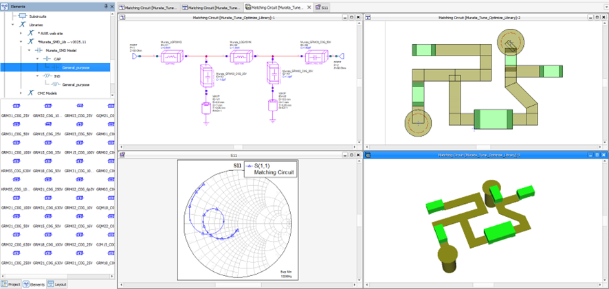

Figure 3. An RF filter in a tee configuration based on inductor and capacitor SMD components from Murata, wired together in a network simulated with Cadence Microwave Office.

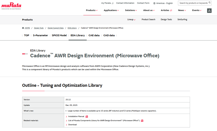

The updated library can be downloaded from the Murata website. Please download the library and take advantage of the new tuning and optimization library.
