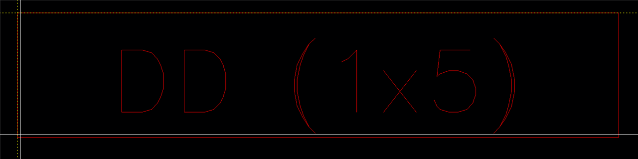

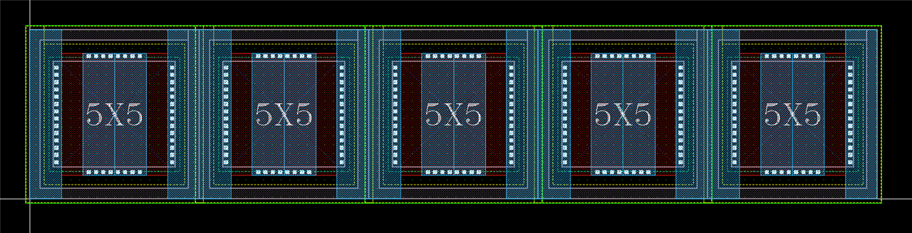

Hi, I'm sorry for my english is poor.
By using dbGetTrueOverlaps(), i want to get coordinate of shape that i want in mosaic or instance...
i placed mosaic named "DD" and i wanted to get coordinate of each "5X5" text in window view.
i used skill language "dbGetTrueOverlaps(geGetWindowCellView() geGetWindowCellView()~>bBox list("text" "drawing") 32 t)"
result is below
because db of each text is same, i didn't get coordinate of each text in window view...
 please help me...

    Did you have a look on the support site, if you search for dbGetTrueOverlaps, you will find dbGetHierPathTransform or dbGetInstTransform quite easily.
    Here is an example:
    let( ( cv hier_paths shape transform )
      cv = geGetEditCellView()
      hier_paths = dbGetTrueOverlaps( cv cv->bBox '( "annotate" "drawing" ) 32 t )
      (foreach hier_path hier_paths
        ;; Here we try to retrieve the last object from the hierarchical path returned by `dbGetTrueOverlaps`
        ;; If it is an object, we keep it as is, if it is a list, we take the last element.
        ;; (This might not be robust enough...)
        if( atom( hier_path )
          then
          shape = hier_path
          else
          shape = car( last( hier_path ))
        ;; It seems that this is the function you are actually looking for
        transform = dbGetHierPathTransform( hier_path ) ;; or `dbGetInstTransform` (they seem identical...)
        (info
          "shape: %N \n\
    shape->objType: %N \n\
    transform: %N \n"
          shape shape->objType transform
