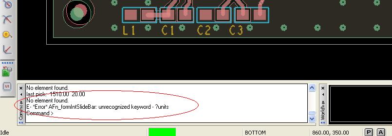

     Dave, I'm facing a strange problem while waking up logomaker. Attached the screen shot. I have reinstalled all files but still same problem. Till few day's ago it was working fine and now not opening. Please help.
    Thanks,
    Shiva.

    eDave over 15 years ago
    Oops. Looks like a bug. I'm away from work until next week. I'll try to sort it out then.
    Dave

     Dave, is there any solution? Still facing the same problem and feeling very strange because of the skill file works fine at my colleague's pc. Both pc's have Allegro PCB design L v16.01.
    Shiva.
