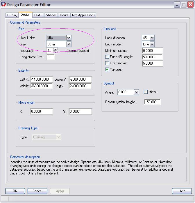

 hi,
Is there any way to display the units of the measurement on the board.
Also board dimension is diplayed only w.r.t inches, how can i see the dimension for different units...i tried changing the units in DESIGN PARAMETERS but no changes.
thnx
  • redwire
    redwire over 16 years ago
    Hopefully you've got it figured out by now.  Dimensioning can be done in any units.... See attached image

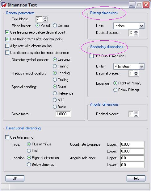

  • redwire
    And the design
  • MAAC
    MAAC over 16 years ago
     Hi Redwire,
    Thnx for the reply..i could change the units according my req. n see the reults...but iam unable to display the units on the board..is there any settings to follow.
     Thnx
  • redwire
    Hmmm...since my answer was as complete as I know measurements I'm not sure I can help further without you attaching a screenshot or board and indicating the problem.  Units are displayed per the two methods I posted.  One is for dimensioning -- the other for layout.  The two are not coupled.

     Hi MAAC,
     Are you saying you want the text when dimensioning a PCB to read "12.030 IN", for example, instead of just "12.030"?
    If so, I don't know how to do that. The title block usually specifies the units so the dimensions themselves only need numbers. I played around with it and I don't see an obvious option nor can I discover it by playing around with the settings in the Manufacture > Dimension/Draft menu.
    If you can't currently do it in Allegro, you could contact Cadence to submit a CCR. Or perhaps you could add a text note which specifies the units either for the entire drawing or (yikes!) on a dimension-by-dimension basis?
