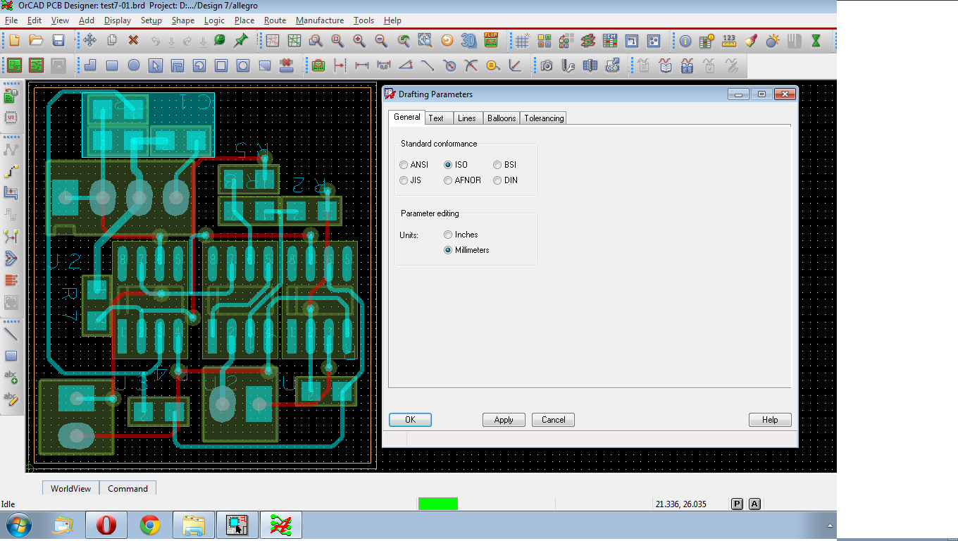

Hi.. For my existing pcb the dimensioning is not get displayed and before dimensioning what are the parameters to be loaded on the drafting parameters.Still keep on trying to dimension the board, the problem still occurs. any one provide the settings to been give for the drafting parmeters. Thanks and Regards Dhamodharann

     The default paramteres are normally acceptable. What's the actual problem ? Have you turned the Board Geometry / Dimension layer on so you can see the dimensions that you have added ?. Are you not seeing the dimension options ? If not try Manuafcture - Dimension Environent then RMB (right mouse button) to set the relevant required dimension type (like Linear Dimension etc).

    Thanks steve.. I had done the mistake to enable the board geometry outline.. Now the dimensions are get viewed. Thanks & regards Dhamodharan
