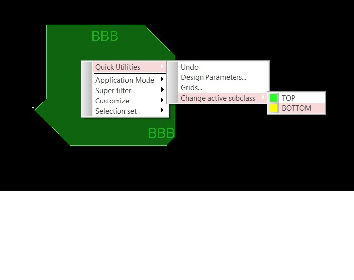

  • steve
    steve over 11 years ago
    Part Logic and Net Logic are menu commands available under the Logic menu that allow you to add components and nets without the need for a schematic. For cross section go to Setup - Cross Section then right click where you want to add a layer and pick Add Layer Above or Below. Set the Type and Material accordingly. To change the layer of a polygon (or Shape) hover over it and use right click - Change to Layer and pick the layer you want.

  • pyohayo
    pyohayo over 11 years ago
    Thanks
    Logic menu - Ok
    For cross section go to Setup - Cross Section then right click ... - Ok
    ... hover over it and use right click - Change to Layer and pick the layer you want - I didn't find such option (please, see the image) ... I've tried Change active subclass, but polygone BBB remained on TOP.
    One more question - can I add my own materials (both cinductors and dielectrics in Material library)
