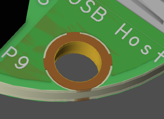

Plated Mounting Hole covered by SolderMask
jatins
jatins over 4 years ago
Hi
I have used 3 plated Mounting Holes in my PCB which are connected to Ground.
In 3d Canvas: Out of these 3 holes, one hole is getting covered by SolderMask on Top and Bottom Layer while the others are shown OK.
Same footprint is used on all 3 holes and i ran Check>Design  Status> Update Shape to Smooth to see if it helps but it doesn't.
Same result when i export  this Step File Out of 3D Canvas.
Using latest hotfix 17.4 S023
  • jatins
    Update: Moving the Incorrect Hole(Hole2) in towards PCB center by 0.5mm seems to resolve the issue. In the earlier(Incorrect) situation, Copper pad of hole was touching the PCB Outline while there is a gap of 0.5mm between PCB Outline and PCB Copper plane.
    And after moving the Hole in by 0.5mm, Copper pad of hole is within the Copper plane circumference and thus, looks OK.
    But the strange thing is the Correct Hole is also lying in the same position i.e. its pad is touching the PCB outline and there is no issue there.

    steve over 4 years ago in reply to jatins
    This must be something to do with the pad definition (check to make sure that the pad isn't using a different padstack name). I have a design here and if I move the pad edge to touch the board outline it displays correctly
    If I move the hole so that the actual hole is beyond the outline it breaks the outline
    So check the soldermask layer as well as the soldermask definition for the padstack.
