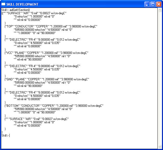

 Hi All,
May I know if there is a function to list all the etch layers in a design (including the layer type, such as plane or conductorl)?
For example if my design has 10 layers named TOP, LAYER2, LAYER3,..... BOTTOM.
How do I get the list of layer names and the corresponding layer type?
Thanks All
  • Ejlersen
    Ejlersen over 17 years ago
    You can use axlGetXSection() which will give you everything you ask for plus more.
    Please see attached picture of running this command in the 'Skill development' window.

    I forgot to mention that if you're only looking for the name of the etch layers you could use
    my_layers = axlGetParam("paramLayerGroup:etch")
    This will give you a list of all the etch layers.
    You could then cycle through these using eg.
    foreach(layer my_layers->groupMembers
      layerparams = axlLayerGet(strcat("ETCH/" layer))
        if(layerparams->type=="PLANE" && layerparams->drcPhotoType=="negative" then
         pm = 0 ; plot mode negative
      else
       pm = 1 ; plot mode positive
    There are many practical uses of this, if you could be more specific about what you wan't there may be an even easier or better way.
