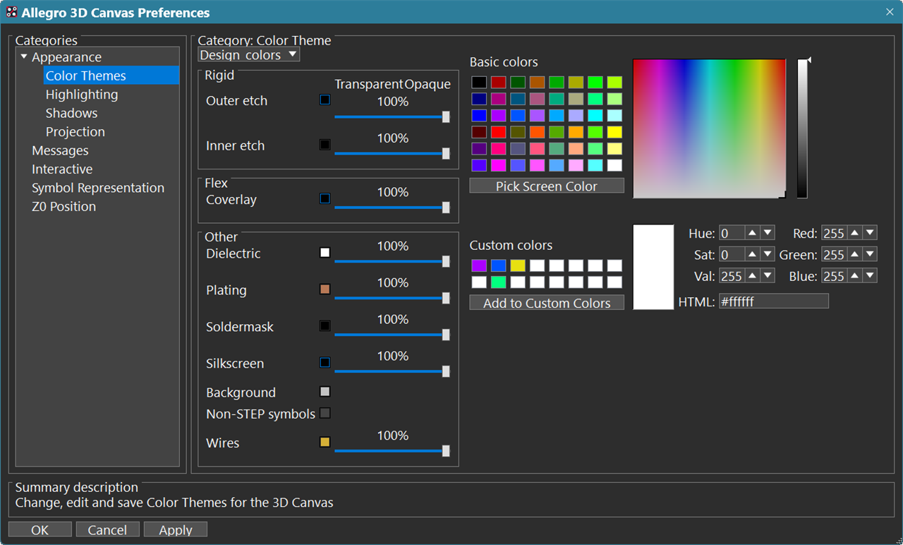

Folks,
I cannot seem to assign a color to the different layers inside the 3D mapper Preferences.  See below:
I am in the correct mode "Design colors", but nothing chnages when I attempt to change any layer to a color I select.  Am I doing something incorrect?
Chris
  • steve
    0 steve 7 months ago
    You can't change the preset ones (the design colours come from the actual 2d colours) but you can add a custom one which you can then modify. If you click in the design colors box dropdown then right click you'll see an Add option, specify a name and you can then set the required colours.

    0 steve 6 months ago in reply to excellon1
    Hi - I have to agree but the good news is that the original 3d canvas has now been given an upgrade. From 23.1 onwards you get access to both the 3d Canvas and the new 3dx canvas (which I'm assuming will replace the original one). This has a Custom theme option which you can modify to suit. :-)
