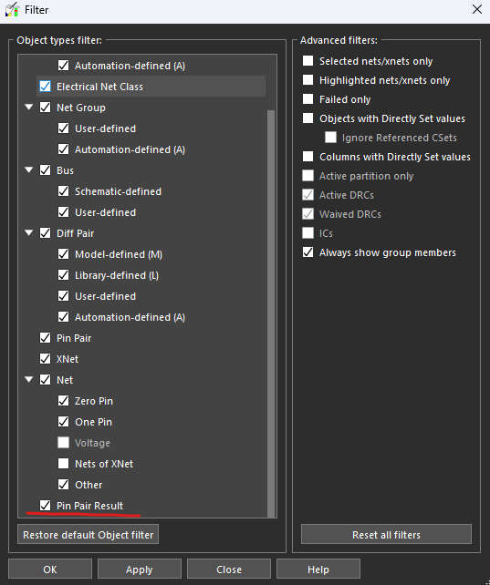

    how can you hide RePP objects if they clutter the worksheet?
  • Vipulc
    0 Vipulc 3 months ago in reply to CF202606104231
    You can hide them by using the Objects > Filter menu in Constraint Manager and disabling the PinPair Result checkbox.
