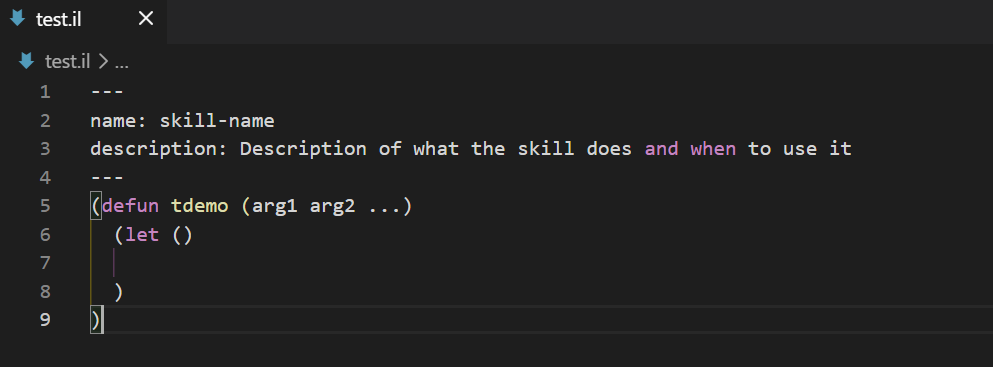

  • Hoangkhoipcb
    Hoangkhoipcb 7 months ago in reply to JuanCR
    Hi JuanCR
    This warning disappeared after I added the name and description to the .il file
  • JuanCR
    JuanCR 7 months ago in reply to Hoangkhoipcb
    hmmm ... Are you sure you can run this file? Because it doesn't seem like this is the correct way of commenting in SKILL syntax
  • Gelzone
    Gelzone 7 months ago in reply to JuanCR
    JuanCR
    You're right.
    I guess the syntax for Cadence Skill and Agent Skills are mixed in this plugin...
    So the way adding name & description in the .il file just for ignoring the message error. If you need to run the code, the section needs to be removed or commented.
