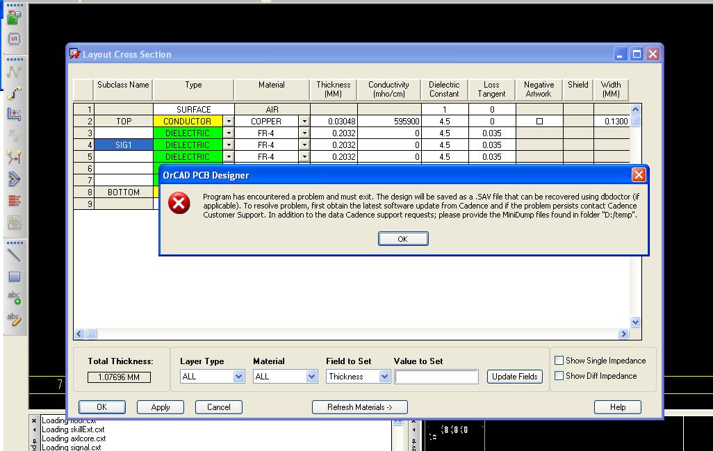

I am facing problem with Orcad PCB editor 16.3 (after updating latest hotfoix "Hotfix_SPB16.30.016_wint_1of1").
If I try to add layers in  Xsenction tool will encounter error and closes.(error message attached)
Any one  facing this problem?how you solved?

    You need to download and apply hotfix 17 or 18, or revert to an earlier hotfix, this seems to an issue specific to hotfix 16.
