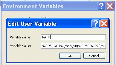

    Yes, try what Steve said.  It could be something to do with your permissions on your PC.
    If that doesn't work, it still sounds like your environment variable path has the path to the Cadence install is hard coded.  I can't see it from your picture and really the only way you can see it is to go to My Computer, right click Properties and in the Advanced tab select Environment Variables.  Highlight the PATH variable and select edit.  The Cadence install path should look something like the the attached picture of my path.

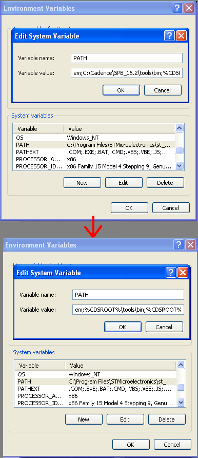

     You need to edit your path.  Based on what you posted, the Cadence tools paths are defined twice.  Remove the hard coded paths, i.e. C:\Cadence\SPB_16.2... and leave the %CDSROOT% paths.
    Chad
  • bluecat
    bluecat over 11 years ago
     Thanks all for your help,
    I was able to to make it work, as Chad said I edit the VARIABLE systems instead of the USER variables(see picture) and everything is working now I am able to swithc from 16.2and 16.6 without a problem.  I  just did: start > my computer (right click) > Properties > Advance > Environment Variables > System variables >(high light) PATH > Edit. and change all "C:\Cadence\SPB_16.2" to %CDSROOT%, then ok to everything and that's it everything is working now.
