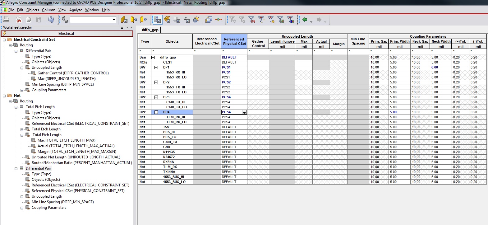

I'm using OrCAD PCB Designer and have created differential pairs. When I manually route the pair, the gap between traces is always zero no matter what I set the gap to in the contraints manager. I'm fairly new to this tool so I'm getting a littel frustrated why it does this. I even found another posting that some provided a .brd design with a diff pair and its own CM settings. When I deleted the traces to then reroute them, I found the same problem, the trace gap went to zero! Is this a license limitation or am I missing something? I've created CSet spacing parameters in the CM.

    I have created Electrical CSet and the Min Line Spacing still is grayed out. I've even created a seperate class and then made the diff pair a member of that class and it's still grayed out. I've pretty well lost all confidence in this tool. There must be some other limiting factor which shouldn't be for a professional license.

    Thanks for your efforts; however when I open it your routed diff pairs exist but the constraints don't when I open the CM and the Min Line Spacing is still grayed out. I'd be curious to know what happens if I try to import your .dcf file. I'm expecting that it would either choke or just grey them out. I could also export my contraints file (.dcf); however I would have expected that to be embedded in the .brd file.
    I created Electrical CSet as suggested earlier in the thread with no luck... still grayed out. I've attached a jpg of the CM with grayed fields in the Min Line Spacing.
    I appreciate all the help and if there is any final thoughts, please let me know.

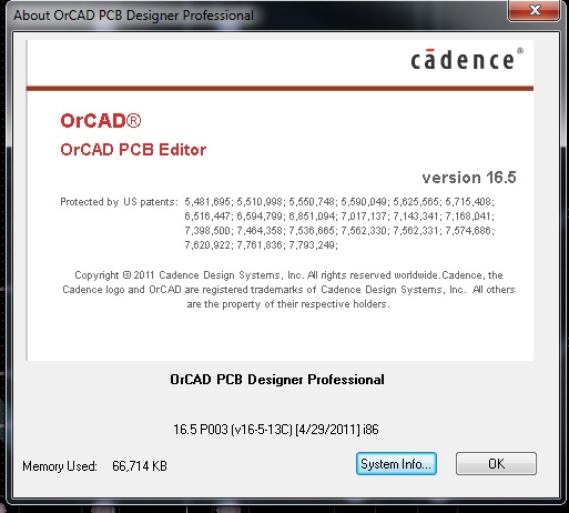

     Can you go to Help - About and upload a screenshot of the exact version of software that you are running.

    Sure thing.... Here you go! Thanks Steve :-)

     You are running the base release from the DVD. I would recommend getting the latest hotfix from your reseller which may/may not help. I also notice that you have been customizing the CM view. Try a View - Options and click on retore default settings and see if that helps. You shouldn't need to cusotmize the view to set MIn Line Spacing..
