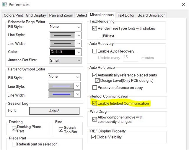

Hi guy!
       I found that select entire net refresh in 17.2 capture is very slow, and there will be similar unresponsiveness in the middle.
This problem mainly occurs when selecting GND or VCC.
       I don't think it's a slow computer response. My computer hardware configuration is Intel i7 3.0 GHz, 8GB RAM, SDD.
In the same DSN file, I tried to refresh it very quickly in 16.6, which would not happen above.
       I wonder if anyone else has encountered this kind of problem?
  • LouShay
    LouShay over 6 years ago
    We're experiencing similar behavior in Capture, and we think we've identified the problem as our anti-virus application (Trend Micro) targeting the application. Please disable the Intertool Communication option and let us know the result.  This is not a solution - just an indicator.   Thanks

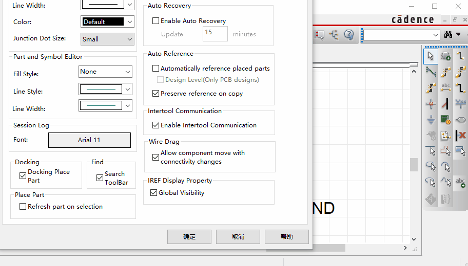

  • Kinzhifeng
    Kinzhifeng over 6 years ago in reply to Kinzhifeng
    Same DSN file in 16.6 , Enable Intertool Communication  (During this period, I did not open Allegro PCB Editor software.)

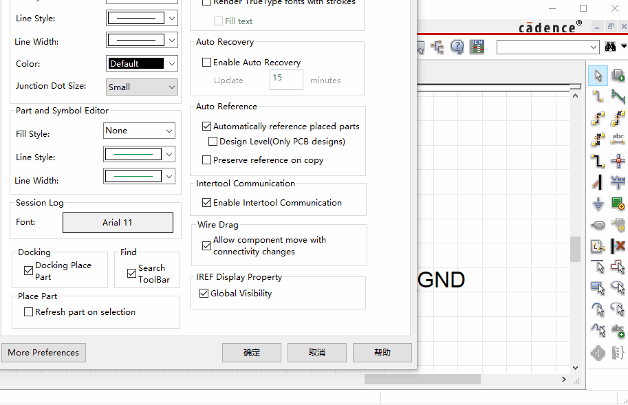

  • Kinzhifeng
    Kinzhifeng over 6 years ago in reply to LouShay
    Same DSN file in 16.6 , Disable Intertool Communication (During this period, I did not open Allegro PCB Editor software.)

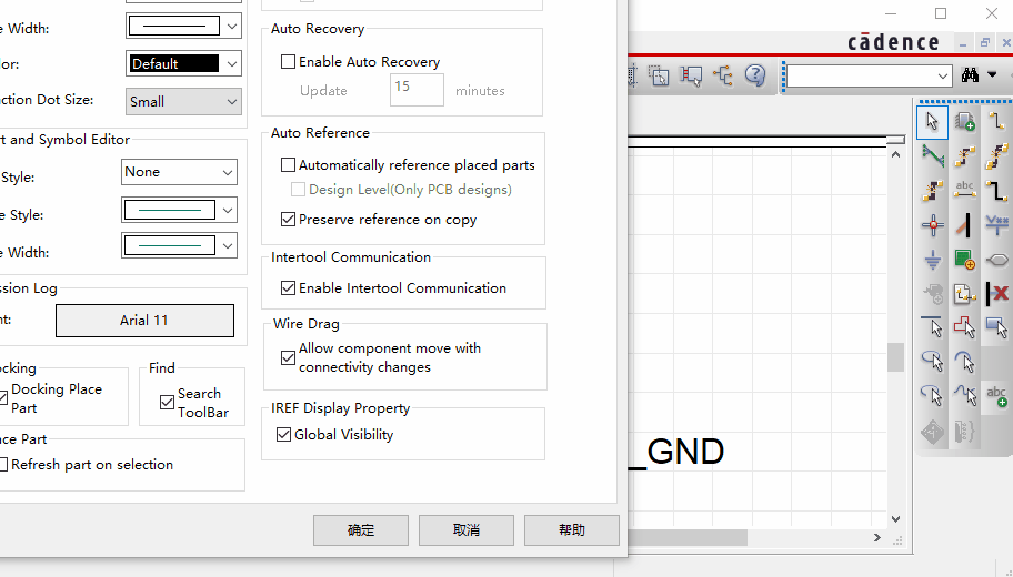

  • Kinzhifeng
    Same DSN file in 17.2 , Enable Intertool Communication (During this period, I did not open Allegro PCB Editor software.)
