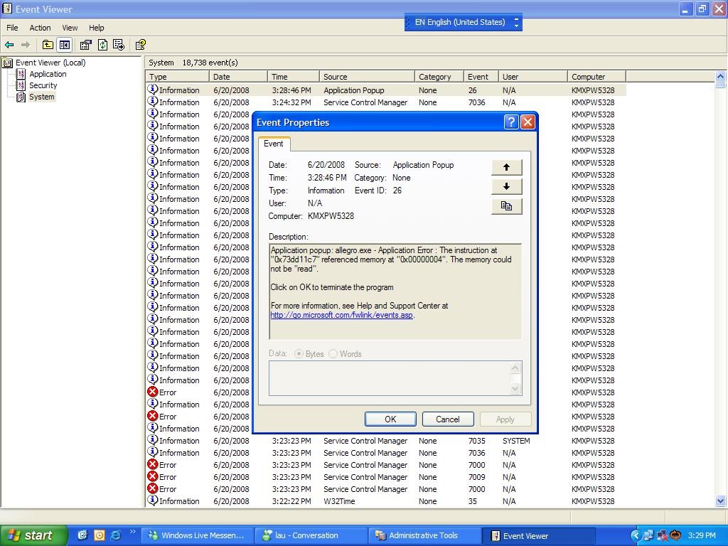

hi all,
       i faced this problem today. Once i double click to add a via, suddenly , allegro editor hang and error message come out. I don't know why because all environment setting is correct. Here's the print screen of the error message.

    Hi have you tried running the DB doctor on the file? normally fixed issues like this.
