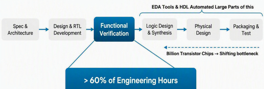

Each new generation in chip design makes chip verification more complex. Today, verification consumes 60-70% of the total engineering hours in chip design.
Verification efforts
Better methodologies, more automation, and additional compute have helped. Even with those advances, however, verification still involves repeated cycles of creating collateral, running analysis, inspecting results, and deciding what to do next. Debugging and coverage closure are among the most time-consuming activities, requiring close coordination between design and verification teams. That coordination becomes more difficult as designs grow in size, complexity, and interdependence.

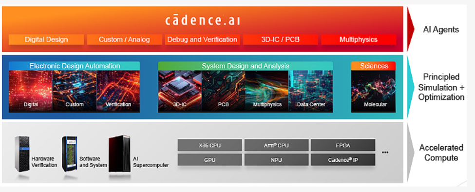

Cadence’s three-layer cake model combines accelerated computing and data at the foundation, principled simulation and optimization in the middle, and AI agents and agentic intelligence at the top. In design verification, this architecture connects agent orchestration to established EDA engines, allowing workflow decisions to draw on engineering tool results rather than on generated outputs alone.

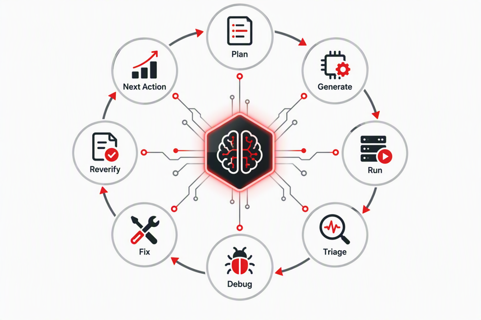

These activities are also interdependent. Running verification produces results. Those results may require analysis. Analysis may lead to additional verification or corrective work. The resulting change then needs to be evaluated again. Agentic orchestration provides a way of connecting those activities. Agentic AI workflow can translate verification intent into plans, and supporting artifacts. It can generate formal and dynamic verification plans, including test benches, SystemVerilog Assertions (SVA), UVM sequences, checkers, and coverage models.
Creating this collateral is a starting point, not proof of correctness. Running verification may produce results that lead to investigation, additional verification, or corrective work. Agentic AI workflow changes the design verification loop.
Understand and plan → Generate → Run → Triage → Debug → Fix → Reverify → Determine the next action
Agentic AI provides orchestration, while Cadence verification solutions evaluate the design and produce results against defined engineering objectives.
