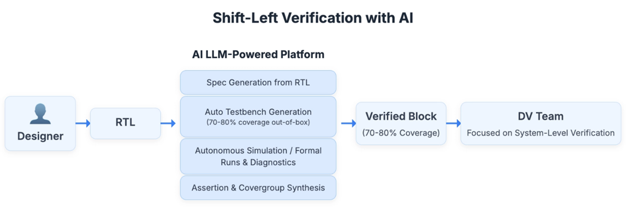

Diagram to represent the verification flow
These tasks now occur in minutes, dramatically compressing the verification cycle. Designers can take on more verification tasks "up front" without deep verification knowledge.
