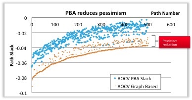

Tempus also has path-based analysis, which leads to better PPA due to reduced pessimism, which leads to minimizing unnecessary fixes, in particular fewer buffers being inserted.

PBA reduces pesimissim
