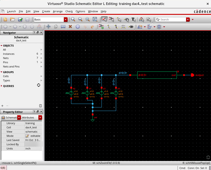

Let us consider the design of a 4-bit DAC using Verilog-A. In DAC modeling, although the input is digital, the analog domain requires these abstract logic levels to be represented as continuous quantities, such as voltages. Logic states are determined from voltage levels by defining a threshold value. For example, if the threshold is 2.5V, any input voltage above this level is a logical ‘1,’ and anything below that is a logical ‘0.’
Once the logic levels are determined, binary weighting, where each input bit contributes a value based on its position, determines the input. For a 4-bit input d3d2d1d0, each bit corresponds to binary weights of 8, 4, 2, and 1, respectively. By adding these weighted contributions together, the digital value translates to an equivalent analog voltage.
Refer to the links below for a complete understanding of data converters modeling in Verilog-A:

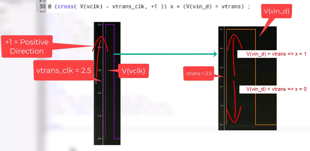

In this video, the D flip-flop demonstrates edge-triggered behavior. A D flip-flop is a digital storage element that captures the input data at a clock edge and holds that value until the next clock edge.
To implement the edge-triggered behavior in Verilog-A, it is necessary to detect the exact instant at which the clock edge occurs. The @cross() operator detects when a signal crosses a defined threshold:
@(cross(V(vclk) - vtrans_clk, +1))
In the above expression, V(vclk) represents the clock signal and vtrans_clk represents the threshold level used to define the switching point. The ‘+1’ argument specifies that the event is only when the signal crosses the threshold in a positive direction, i.e., during the rising edge of the clock. Thus, the Verilog-A expression ensures that an event occurs precisely at the rising edge of the clock signal.
D Flip-Flop - @cross Operator in Verilog-A
